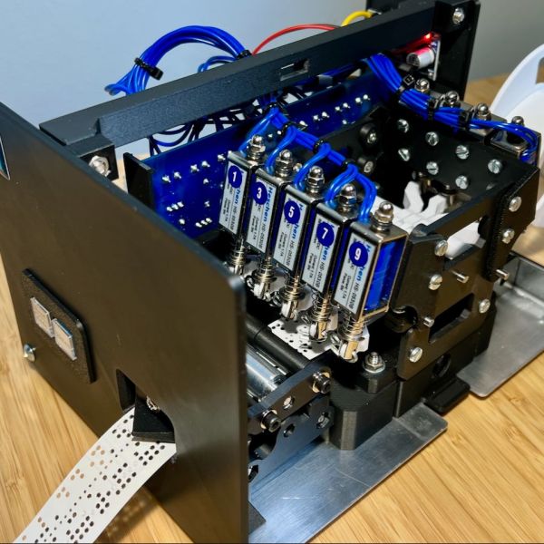

The solenoid and punch side of the machine. {Credit: Simon Boak)
Although [Simon Boak] had no use for an automatic paper tape punch, this was one of those intrusive project thoughts that had to be put to rest. With not a lot of DIY projects to look at, the first step was to prototype a punch mechanism that would work reliably. This involved the machining of a block of aluminium with holes at the right locations for the punch (HSS rods) to push through and create holes into the paper without distortions. Next was to automate this process.
To drive the punches, 12V solenoids were selected, but using leverage to not require the solenoids to provide all the force directly. On the electronics side this then left designing a PCB with the solenoid drivers and an Arduino Nano-style board as the brains, all of which including the Arduino source can be found on GitHub. Much like with commercial tape punch machines, this unit receives the data stream via the serial port (and optional parallel port), with the pattern punched into the 1″ paper tape.
One issue was finding blank paper tape, for which [Simon] cut up rolls of thermal paper using a 3D-printed rig with appropriately installed sharp blades. This paper tape seems to work quite well so far, albeit with the compromise that due to the current drawn by each solenoid (~1.7A) only one solenoid gets activated at any time. This makes it slower than commercial punch machines.

    1. The paper (and mylar) tape itself is getting somewhat scarce and expensive. I’ve built tape readers by adding new electronics to industrial mechs, and I’ve built a few readers from scratch, but this project would be beyond me. I hope that someone picks it up and builds up a kit to sell.
      It’s mentioned that this punch is slowed down somewhat because the solenoids don’t fire at once. My two commercial DSI punches work up to 300 baud with, not surprisingly, big-a transformers, a bridge or two, and big capacitors. They don’t make ’em like they used to, because no one could afford it!
      1. There are some mylar based wide format inkjet papers out there that would probably work much better for this because receipt paper, even if they have reduced PFAs, usually still have it in the coating.

  1. I think that some praise should be given to the quality of the build. The details such as the wiring, and how the enclosure is built including the fascinating mechanics, are a true feast for the eyes. The Step model on git really allows to appreciate the work done.

  5. I can only see the pictures and hear the sound, but from the sound it does not seem to be quite up to the speed of the classics.

    It seems to pre-set a whole line of holes to be punched and then punch the character in one go from what I gather.
