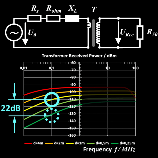

These days, if you want to explore any part of the radio spectrum, you can probably do it easily with a software-defined radio (SDR). But the antenna is the key part that you are probably lacking. A small antenna will not work well at all. While the video covers a fairly common idea: using a loop antenna, his approach to loops is a bit different using a matching transformer, and he backs his thoughts up with modeling and practical results.

  2. Transformer coupled radio input stages seem to be a lost art nowadays. Back in the tube era, practically all receivers from LF to VHF/UHF used some kind of step-up transformer to get voltage gain without extra noise for free. Also making the loop antenna resonant at the desired frequency helps a lot.
    1. Transformer input stage is one of the most noisy gain choices in modern times. The thermal noise from all that winding is way higher than a modern low noise opamp
      1. Not necessarily, a very low-noise opamp (for example LT1115) still has an input noise density of 0.9 nV/sqrt(hz). This is about equivalent to the thermal noise of a 50 Ohm resistor at room temperature – and as long as the transformer resistance (input winding resistance plus transformed output winding resistance, including the skin effect) is a lot less than that, the transformer can still improve noise performance.
