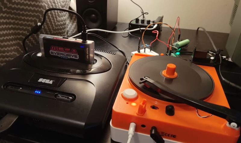

Recently [Throaty Mumbo] took a poke at another daft idea, in the form of loading Sega Genesis games off vinyl records. Although a whacky idea, it’s made possible through the use of a Mega Everdrive Pro and its ability to load games via its USB port, a feature mostly intended for on-the-fly game development without swapping SD cards.
For a few decades in home computing, the loading of software from cassette tapes and similar media was very common. This was due to the low-cost nature of this ubiquitous technology compared to alternatives like cartridges and floppy disks. Even if it was famously unreliable and slow, this accessibility made it a very popular choice. This is where home game consoles were different, as they generally used very fast cartridges, but what if you merge these two worlds?
As demonstrated, a Pico 2 board with its RP2350 MCU is used to convert the audio signal containing the binary data into data for transmission via USB to the Everdrive cartridge. After confirming that it works with a tape drive, he drags in a plastic-y PO-80 5″ record cutter and player, where the mono audio limitation is not a problem.
Unfortunately, this PO-80 turns out to be exactly the kind of toy it looks like, with [Throaty Mumbo] unable to cut and play back a record that gets a clean enough signal to the Pico 2 board, though with a better player and likely record cutter it should work fine. After all, some magazines back in the day came with plastic ‘vinyl’ records that contained programs you could load from your record player.
Although technically a failure, it does demonstrate that if you are very patient, you can totally load Sega Genesis ROMs off a tape or record at a blistering couple of kB/s, tops.

    1. As far as this video goes, the record cutter does not supply enough audio ‘bandwidth’ to allow for proper distinct milliseconds long ‘blips’ of audio that represent the 1s and 0s. So these bits get muddled together. To grossly oversimplify things a bit:
      The cart expects:
      101010101010
      But what’s recorded on the record is more like:
      111001110111 despite attempting to record 101010101010
      And that’s even before the flutter that happens when both recording and playing back the record (doubled up flutter).
      So, no, this cutter/player has no chance of sucessfuly recording and playing back data with a much higher baud rate than say the WWV time signal (ouch!)
