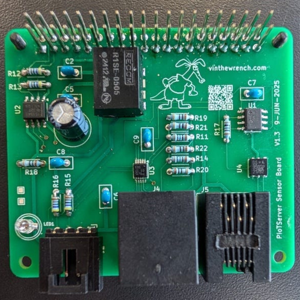

We’re used to interfaces such as I2C and one-wire as easy ways to hook up sensors and other peripherals to microcontrollers. While they’re fine within the confines of a small project, they do have a few limitations. [Vinnie] ran straight into those limitations while using a Raspberry Pi with agricultural sensors. The interfaces needed to work over long cable runs, and to be protected from ESD due to lightning strikes. The solution? A custom Pi interface board packing differential drivers and protection circuits aplenty.
The I2C connection is isolated using an ISO1541 bus isolator from TI, feeding a PCA9615DP differential I2C bus driver from NXP. 1-wire is handled by a Dallas DS2482S 1-wire bus master and an ESD protection diode network. Even the 5-volt power supply is delivered through an isolated module.

  1. “I also added the DS9503P ESD Protection Diode, which gave my circuit approximately 27 kV of isolation.”
    Nope. Not with that series R. and not with that PCB layout. Methinks his ‘Zeus filter’ may have similar problems.
    1. Thinking about it more.. my actual application (this was a test board) does bring the OW right up to the connector and I will remove the resistor and tighting the grounding.. do I need to do more?

    1. 27kV could jump up to 30mm in air (worst case) so you could pot everything is special isolating epoxy, and put all components as far away from each other as possible. also induction might still be a problem and could maybe fry some stuff.
  2. Given the voltage present in a lightning strike, I wouldn’t even try to design my own system with copper. Instead I’d power each node with battery and/or solar, and communicate via RF. Then a strike takes out at most one node.
  3. Just running I2C over several meters is problematic, increased capacitance will dull the edges on bus transitions, smaller pull-ups will somehow mitigate that but will consume more current, going RF with something like nRF24L01 mesh sounds overall a better strategy, also limiting the exposure to lightning strikes.
