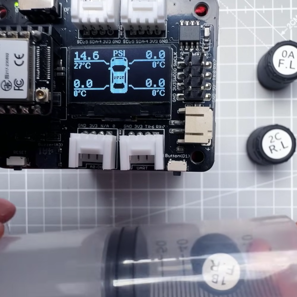

When [upir] saw that you could buy tire valve stem caps that read pressure electronically, he decided to roll his own Tire Pressure Monitoring System (TPMS) like the one found on modern cars. An ESP32 and an OLED display read the pressure values. He didn’t have a car tire on his workbench though, so he had to improvise there.
Of course, a real TPMS sensor goes inside the tire, but screwing them on the valve stem is much easier to deal with. The sensors use Bluetooth Low Energy and take tiny batteries. In theory, you’re supposed to connect to them to your phone, although two different apps failed to find the sensors. Even a BLE scanner app wouldn’t pick them up. Turns out — and this makes sense — the sensors don’t send data if there’s no pressure on them, so as not to run down the batteries. Putting pressure on them made them pop up on the scanner.
The scanner was able to read the advertisement and then correlate pressure to the data. He discovered that someone had already decoded standard TPMS BLE data, except the advertisements he found were significantly longer than his own. Eventually he was able to find a good reference.
The data includes a status byte, the battery voltage, the temperature, and pressure. Once you know the format, it is straightforward to read it and create your own display. Many people would have ended the video there, but [upir] goes into great detail — the video is nearly an hour long. If you want to duplicate the project, there’s plenty of info and a code repository, too.
If you need to read the regular RF TPMS sensors, grab a software-defined radio. Many of these sensors follow their own format though, so be prepared.

I might actually make this in the future. My main problem is that most of these TPMS systems assume you have 2 or 4 wheels, but my 60’s carrier (like a pickup truck bed with a motorcycle attached to the back of it) has three wheels. Two at the front, one in the rear. When you get a TPMS for 4 wheels it usually complains and beeps when you only connect 3, and it’s just not as nice looking. This would be a nice project to recreate for my specific use case.
You don’t carry a spare tire? Just for the math to work out, of course.
For a quick and dirty workaround, put the fourth on your spare tire.
Not sure that’ll work on my belt.
Throw the fourth sensor in a container of PVC with a Schrader valve so that you can pressureize the fourth sensor.
A few options, if its reverse engineered you can re-write the rom and write the ID for the one you are using twice (over the one you aren’t).
Second option is put it inside a pressurized container, which could be as simple as a bolt threaded into a tire stem to put the spare cap on. If you can seal the bolt it will build pressure.
Put two sensors on one tire?
Put one sensor on a proxy, like maybe just a modified section of bicycle inner tube, or even a small piece of pipe with a valve stem stuck in a cap. I wouldn’t be too scared of continuously holding 20-30 PSI in PVC.
It will complain when one wheel is missing, but after beeping for a moment it stops nagging and from that point works just fine with three.

Here’s my implementation of it that pushes the data on a CANBUS to be logged by an AIM dash https://github.com/torqu3e/aim-tpms

Bought ones with the same protocol. They stop sending data about 6 minutes after parking.
