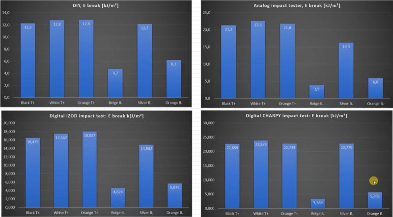

According to Bambu Lab’s claims for the filament, it’s supposed to have ‘up to’ double the layer adhesion strength as their basic PLA, while being much more robust when it comes to flexing and ‘taking a beating’. Yet as [Igor] goes through his battery of tests – comparing PLA Tough+ against the basic PLA – the supposedly tough filament is significantly worse in every count. That sad streak lasts until the impact tests, which is where we see a curious set of results – as shown above – as well as [Igor]’s new set of impact testing toys being put through their paces.
Of note is that although the Tough+ variants tested are consistently less brittle than their basic PLA counterparts, the Silver basic PLA variant makes an unexpectedly impressive showing. This is a good example of how color additives can have very positive impacts on a basic polymer like PLA, as well as a good indication that at least Bambu Lab’s Basic PLA in its Silver variant is basically better than Tough+ filaments. Not only does it not require higher printing temperatures, it also doesn’t produce more smelly VOCs, while being overall more robust.

  2. Interesting, silver PLA is strong. I have noticed white PLA being weak. I would like to see a study regarding color side-effects.
    1. CNC Kitchen has a study about how color affects strength from January 2023. Pigments can definitely affect properties. I find gray filaments tend to be consistently strong, and I’ve had issues with white as well.
    2. I saw videos by this guy that showed Silver PLA stronger. He did not test Silver PLA Tough+ to see if it is stronger. I’d be interested.
