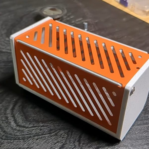

Turning A $2 IKEA Lantern Into A Stylish Enclosure
It’s fair to say that the average Hackaday reader enjoys putting together custom electronics. Some of those builds will be spaghetti on a breadboard, but at some point you’ll probably have a project that needs a permanent case. If you’re looking for a small case for your latest creation, check out [Julius Curt’s] modification of an IKEA Vårsyren lantern into a customizable enclosure!

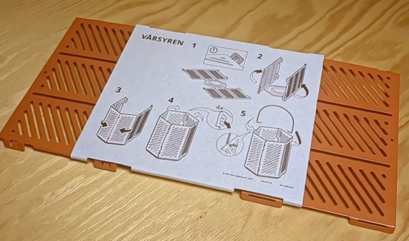

Like most things IKEA, the Vårsyren lantern is flat pack — but rather than coming as a collection of wooden components, the lantern is made of sheet metal. It’s hexagonal in shape with a pair of three sided panels, so [Curt] simply snaps one of them off to make three sides of the final case. The other three sides are 3D printed with the STEP files provided so the case can be made to fit anything around 60x60x114 mm in size.

  3. You had me… until the part where they 3d printed 3x FLAT RECTANGULAR SIDES.
    This is something to be shamed, not lauded.

    1. I was thinking this too. They really missed the opportunity to do it up right with a bit of hardwood. Or even G10 sheet if they were concerned about it’s enclosure properties. Even if I just wanted white plastic, it would have been better to cut some HDPE.
        1. Who cares?
          It is a DIY project box that someone might make a few of at most.
          If you need high tolerance, or thermal stability, you shouldn’t be 3d printing anyway.
          Laser cut it from a sheet of ABS?
          Or a hacksaw?
          Of course, you would be fabricating 3 of the 6 sides at this point, so why are you bothering with the Ikea parts? They look cool I guess.
          The point is that the $2 Ikea item is only partially used.
          They didn’t find a clever way to make a project box by reconfiguring the lamp parts.
          They cut off a single part of the lamp and stuck it on an expensive 3d printed box.
          1. The point is that the $2 Ikea item is only partially used.
            Well, they could use the other 3 panels to make a second enclosure.
    2. I don’t have access to a laser cutter. If I need a flat sheet with irregular holes, I can do it at home on the 3D printer, or as a simple PCB which I can have fabbed for cheap by mail order.
      Usually the 3D print wins because I can have it this afternoon, and I can also print it with raised features to accommodate other parts.
    3. No, they did not. each piece is profiled. the side pieces look flat, but are L shaped with recessed areas to hold and retain the shape. I agree you could make this look more aesthetic, but if you’re going to shame people, at least look at it first. :D
