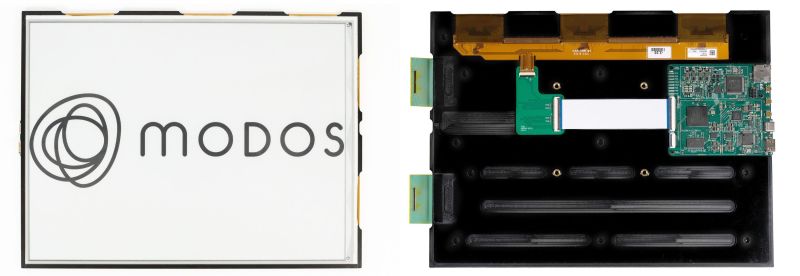

Front and back view of the 13.7" monitor kit

Now that we’ve defended the idea, let’s get to the good part: it’s not just a monitor being crowdsourced. The driver board, called Glider, is fully open with code and design files on the Modos Labs GitHub repository. We sometimes complain about what counts as open hardware, but these guys are the true quill. Glider is using an FPGA with a custom clever configuration to get screens refreshing at that impressive 75 Hz. With the appropriate panel (there’s a list on Git– you’ll need an E Ink branded display, but you aren’t limited to the 13.3″ panel) the board can drive every pixel independently, forcing updates only on those pixels that need them. That’s an impressive trick and we’re not surprised it needed an FPGA to pull off. (It uses a Xilinx Spartan 6, for the record, running a config called Casper)
Because everything is open source, you can do things like you see in the API demo video (embedded below), where every panel in what looks like a tiled display manager is running a different picture mode. (There are more demo videos at the CrowdSupply page). We’re not sure how often that would come up in actual use– that functionality is not yet exposed to a window manager, for example, though it may yet be. Perhaps more interesting is the ability to customize specific refresh modes oneself, rather than relying on someone else’s idea of what a “browsing” or “gaming” mode should be.
