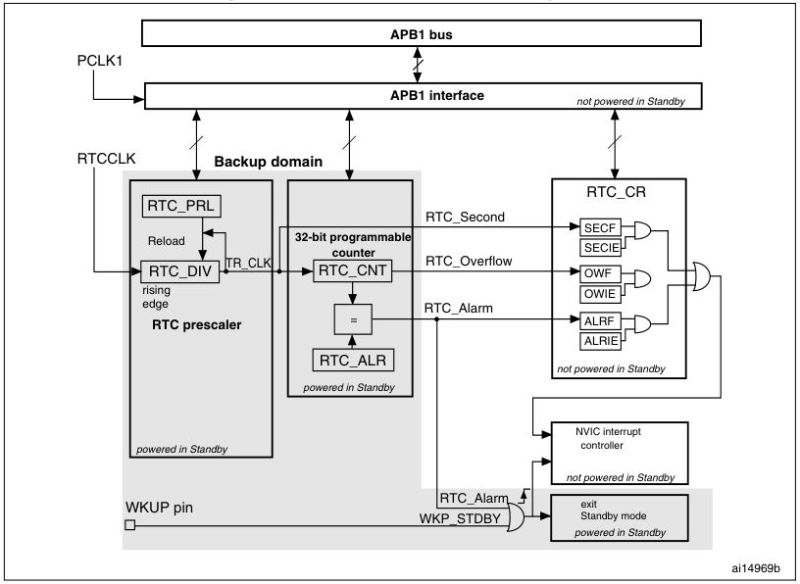

Thus, the logical RTCCLK choice for an RTC that has to survive any and all adverse power events is the LSE as it feeds into the RTC. Take for example the STM32F103 RTC block diagram:
Simplified RTC diagram of the STM32F103. (Source: RM0008)
Here we can see the elements of the very basic RTC1 peripheral, with the sections that are powered by VBAT marked in grey. The incoming RTCCLK is used to generate the RTC time base TR_CLK in the RTC prescaler, which increases the value in the RTC_CNT register. It being a 32-bit register and TR_CLK usually being 1 Hz means that this counter can be run for approximately 136 years if we ignore details like leap years, without overflowing.
For initializing and using the RTC1 peripheral, we can consult application note AN2821 alongside reference manual RM0008, which covers a clock and calendar implementation, specifically on the STM3210B-EVAL board, but applicable to all STM32F10x MCUs. If you want to keep a running calendar going, it’s possible to use the backup registers for this whenever the counter reaches a certain number of seconds.

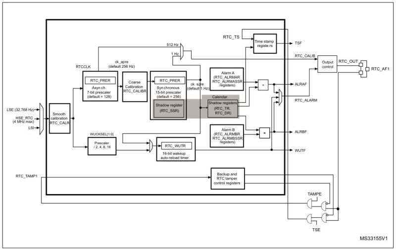

Correspondingly, the block diagram for the RTC2 peripheral is rather more complicated:
Block diagram of the RTC 2 peripheral in the STM32F401 MCU. (Source: ST, RM0368)
Although we can still see the prescaler and backup/tamper registers, the prescaler is significantly more complex with added calibration options, the alarms span more registers and there are now three shadow registers for the time, date and sub-seconds in RTC_TR, RTC_DR and RTC_SSR respectively. This is practically identical to the RTC3 block diagram.

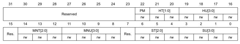

These shadow registers lay out the individual values as for example in the RTC_TR register:
The RTC_TR register in the STM32F401. (Source: ST, RM0368)
Taking the seconds as an example, we got the tens (ST) and units (SU), both in BCD format which together form the current number of seconds. For the minutes and hours the same pattern is used, with PM keeping track of whether it’s AM or PM if 12 hour format is used. Effectively this makes these shadow registers a direct source of time and calendar information, albeit generally in BCD format and unlike with the basic RTC1 peripheral, using it as the source for C-style functions via Newlib has become rather tricky.
