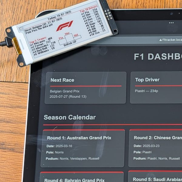

Off to the races? Formula One races, that is. This project by [mazur8888] uses an ESP32 to keep track of the sport, and display a “live” dashboard on a 2.9″ tri-color LCD.
“Live” is in scare quotes because updates are fetched only every 30 minutes; letting the ESP32 sleep the rest of the time gives the tiny desk gadget a smaller energy footprint. Usually that’s to increase battery life, but this version of the project does not appear to be battery-powered. Here the data being fetched is about overall team rankings, upcoming races, and during a race the current occupant of the pole-position.
There’s more than just the eInk display running on the ESP32; as with many projects these days, micro-controller is being pressed into service as a web server to host a full dashboard that gives extra information as well as settings and OTA updates. The screen and dev board sit inside a conventional 3D-printed case.
Normally when talking Formula One, we’re looking into the hacks race teams make. This hack might not do anything revolutionary to track the racers, but it does show a nice use for a small e-ink module that isn’t another weather display. The project is open source under a GPL3.0 license with code and STLs available on GitHub.

  4. I was really curious how the ESP slept while hosting a web page for configuration. A scan through and it looks like it isn’t really sleeping but idling.
    I was hoping there was gonna be some new magic I didn’t know about so I’m a bit disappointed but it’s still a cool project. And if anyone on a high level than me sees the magic I missed please reply.
    1. You could put the ESP in either deep sleep or hibernation mode and wake it up with rtc for web updates, then make the web configuration page available for eg. 30 minutes after a power on or via a dedicated button, this should minimize the power draw from the ESP, just be aware if your board uses a LDO voltage regulator, this will probably draw more power than the sleeping/hibernating ESP ;-)
  5. Has anybody got a good source for weatherproof e-ink displays in the 30- to 40-inch range, in single – unit quantity, preferably priced for an amateur developer? Black – red or better would be great, but I could probably live with monochrome. Resolution does not have to be great; this would be signage rather than user screen. Keeping weight down will also be great; the device needs to be fairly easily carryable.
    I have no idea whether my application would actually make sense, but the only way to really find out is to build a prototype and figure out what the minimum cost would be.
  6. To clarify, this project doesn’t go to deep sleep as it isn’t battery powered.
    millis counts 30mins and fetches new data from api, so dashboard stays available all the time.
    30 mins refresh is overkill here, races are average once every 2 weeks anyway, and there is no new data until quali. I could probably modify it to start deep sleep based on quali day before main race and let device sleep for week or two, but it works fine as it is now.
