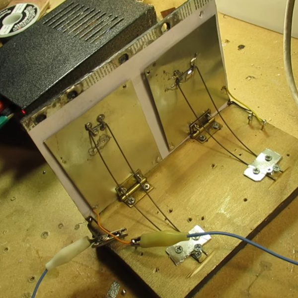

Radio experimenters often need a variable capacitor to tune their circuits, as the saying goes, for maximum smoke. In decades past these were readily available from almost any scrap radio, but the varicap diode and then the PLL have removed the need for them in consumer electronics. There have been various attempts at building variable capacitors, and here’s [radiofun232] with a novel approach.
A traditional tuning capacitor has a set of meshed semicircular plates that have more of their surface facing each other depending on how far their shaft is turned. The capacitor presented in the first video below has two plates joined by a hinge in a similar manner to the covers of a book. It’s made of tinplate, and the plates can be opened or closed by means of a screw.
The result is a capacitor with a range from 50 to 150 picofarads, and in the second video we can see it used with a simple transistor oscillator to make a variable frequency oscillator. This can form the basis of a simple direct conversion receiver.

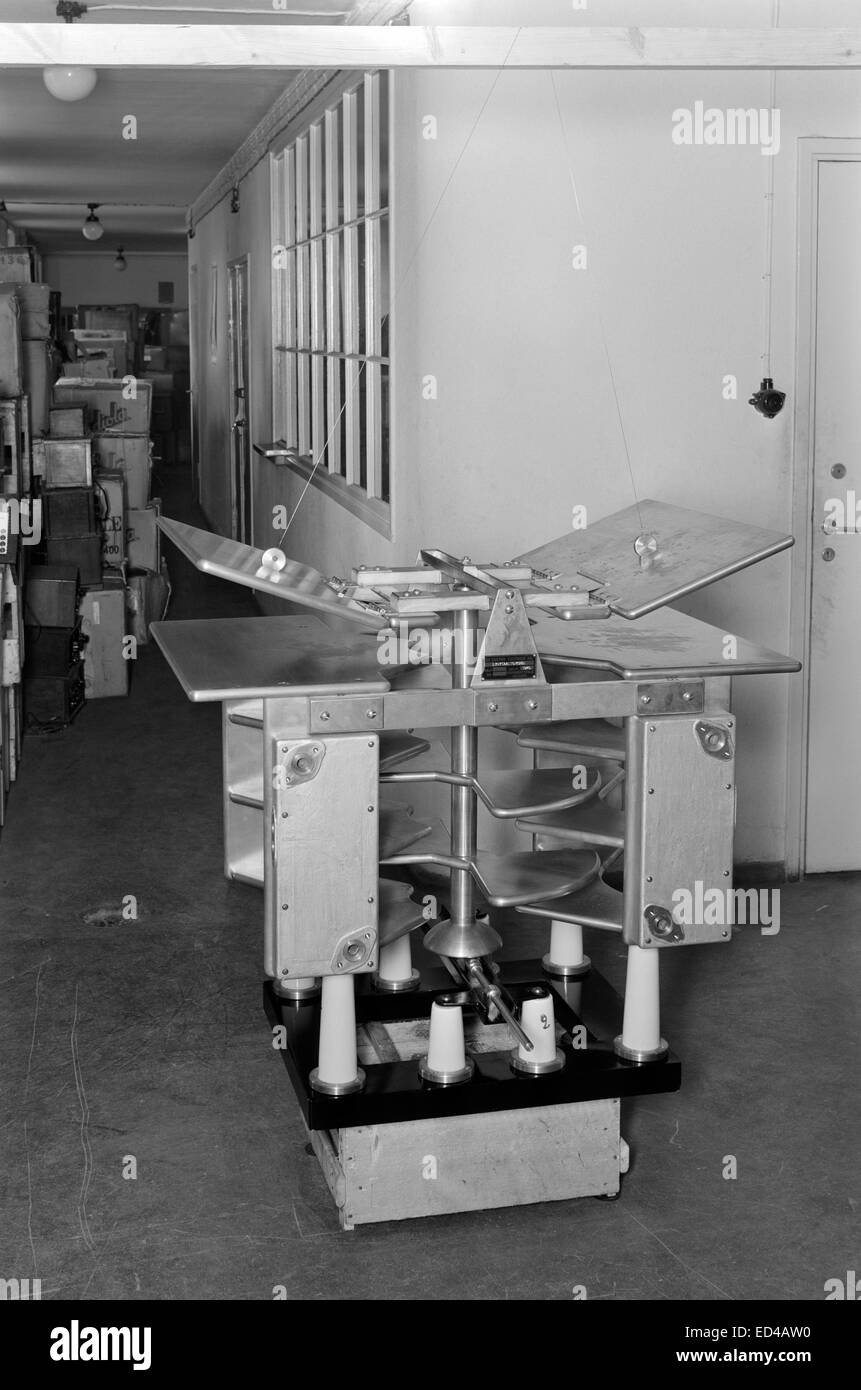

  1. Mann-Russell Electronics of Tacoma, WA made RF gluing machines for wood glues. Hand held and also very large for things like their continuous beam presses that made architectural wood beams. The wood was fed continuously, squeezed and passed between long aluminum plates. It took about 4 minutes to pass through and the glue was cured. There were small units of a few kw and large ones of a Mw. The company made their own RF transformers and had a side-market for commercial radio stations. The gluing machines ran at around 1MHz and had a problem with variations due to water content of wood, etc. The capacitors in the transmitter were large aluminum plates at least 60x60cm. The problem was solved with a hinge on one side and a stepper motor driving a rod at the other side to vary the gap, around 1978, with a digital frequency counter circuit.
    Mr. Mann, a shop teacher, and Mr. Russell, the business man (and uncle of the Russell 2000), were convinced they were making microwaves. I’m sure it was a Maxwell Induction Current.
