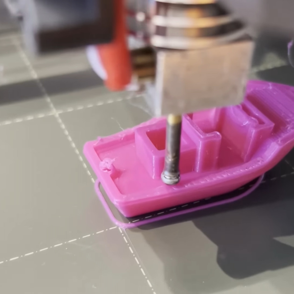

Ironing is the act of going over the top surface of your print again with the nozzle, re-melting it flat. Usually, this is limited to working on boring horizontal surfaces, but no more! This post-processing script from [Tenger Technologies], coupled with a heated, ball-shaped attachment, lets you iron the top of arbitrary surfaces.
At first, [Ten Tech] tried out non-planar ironing with a normal nozzle. Indeed, we’ve seen exactly this approach taken last year.  But that approach fails at moderate angles because the edge on the nozzle digs in, and the surrounding hot-end parts drag.
[Ten Tech]’s special sauce is taking inspiration from the ball-end mill finishing step in subtractive CNC work: he affixed the round tip of a rivet on the end of a nozzle, and insulating that new tool turned it into an iron that could smooth arbitrary curvy top layers.
One post-processing script later, and the proof of concept is working. Check out the video below to see it in action. As it stands, this requires a toolhead swap and the calibration of a whole bunch of new parameters, but it’s a very promising new idea for the community to iterate on. We love the idea of a dedicated tool and post-processing smoother script working together in concert.

  2. ‘arbitrary curvy top layers’
    Obviously false.
    The benchy shown has corners too tight for the tool to reach.
    Doesn’t necessarily need a tool change.
    Mount multiple ‘ball irons’ at nozzle height around the nozzle.
    Should clear during regular layer print.
    Tapered copper rods threaded into edges of heat block, user picks the number, end radius, rod diameter, offset, shape etc.
    Covered in thermal insulator, except at ends.
    Putting them on the model top and sides becomes a software problem.
    Not every spot will be reachable, but most will, at one layer or another.
    Point is, no tool change required, runs at end of every layer.
    Might require part cooling be turned off, or irons will get cold.

        Interestingly, his ball tip for ironing, might just be a solution for non-planar printing, once someone can figure out how to wrap enough nichrome or an induction heater etc. around a long thin bar shaped nozzle :-)
        Some of the newer hotends like creality unicorn or bambu could also be a reasonable method, if someone can move the model cooling fan ducts out of the way.
        1. The long thin bar like nozzle heating wouldn’t be a problem, not going to be quite as energy efficient no doubt but actually get hot enough is easy. The tricky bits are going to be that long thin to fit when ironing into more spaces is going to lead to a more flexible nozzle that is likely to have terrible positional accuracy as the filament path probably does have enough force to pull it out of shape, it likely rings all on its own with the printer movements for rather artifact covered prints, and being such a long melt zone the control of the filament to extrusion effect is going to be very wonky, with lots of drips as you can’t retract all the melty stuff etc.
          I think if you really wanted to make that concept work you have to be getting into the 1.2mm or larger nozzle sizes and appropriately large prints – so perhaps good for printing a large object like a kayak with really fantastic surface finish that might just be watertight on your treadmill based printer, but in general a separate ironing tool just has to be the best option.
