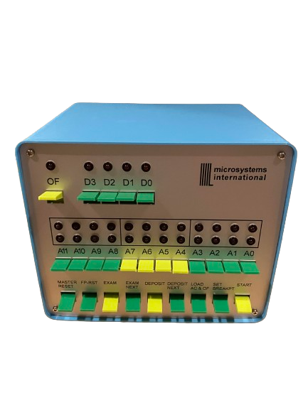

[Michael Gardi] wrote in to let us know about his project: CPS-1: Imagining An Early 70s 4-bit Microcomputer.
The CPS-1 was the first Canadian microprocessor-based computer. It was built by Microsystems International Ltd. (MIL) in Ottawa between 1972 and 1973 and it is unknown how many were made and in what configurations. The CPS-1 supported a 12-bit address bus and a 4-bit data bus. MIL also developed the supporting hardware including RAM. The processor was called the MIL 7114.
[Michael] worked in collaboration with [Zbigniew Stachniak] from York University Computer Museum. [Zbigniew] had developed a MIL CPS-1 Emulator and [Michael]’s job was to implement a front panel hardware interface for the emulator which runs on a Raspberry Pi. The only complication: there are no remaining CPS-1 computers, and no known photographs, so no one can say for sure what a real front panel might have looked like!
With a bit of guess work and 3D printing, as well as some inspiration from contemporaneous hardware such as the DEC PDP-11, [Michael] came up with an implementation. He used an IO extender HAT which adds 32 IO pins to the existing Pi GPIO pins that are accessible via an 3-wire I2C interface. This was enough hardware to support the 26 switches and 29 LEDs on the panel. There’s a brief demo of the custom printed switches in the video embedded below.
