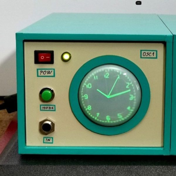

Superlatives are tricky things. [mircemk]’s guide “How to make Simplest ever Oscilloscope Clock” falls into that category. It’s that word, simplest. Certainly, this is an oscilloscope clock, and a nice one. But is it simple?
There’s a nice oscilloscope circuit with a cute 2″ 5LO38I CRT and EF80 tubes for horizontal and vertical deflection that we’d say is pretty simple. (It’s based on an earlier DIY oscilloscope project [mircemk] did.) The bill of materials is remarkably sparse– but it’s modules that do it. One entry is a DC-DC step up supply to get the needed HV. Another is a LM317 to get 6.3 V to heat the tubes. The modules make for a very simple BOM, but on another level, there’s quite a bit of complex engineering in those little modules.
When we get to the “clock” part of the oscilloscope clock, that quandary goes into overdrive. There’s only one line on the BOM, so that’s very simple. On the other hand, it’s an ESP32. Depending on your perspective, that’s not simple at all. It’s a microcomputer, or at least something that can play at emulating one.
Oh, in the ways that matter to a maker — parts count, time, and effort, this oscilloscope clock is very simple. The fact that its actually a vector display for a powerful little micro just adds to the versatility of the build. We absolutely love it, to be honest. Still, the idea that you can have millions of transistors in a simple project — never mind the “simplest ever” — well, it just seems weird on some level when you think about it.
It all comes back to what counts as “simple”. If we’re taking lines on a BOM, arguably this would be even simpler if you used an existing oscilloscope.

  2. nice project, but that schematic…. yikes!
    it took ke a full 5 minutes to convert it in my head to something i understand.
    may i suggest putting the input tubes to the left so the signal path is traversing from left to right on the schematic. then putting the +350v line on top would also help. now the tube. it has numbered pins, does it has corresponding signal input james as well? i think they are positioned from left to right as the electrons go from cathode to anode and beyond though the deflection plates, but that’s just a guess.
    a clear ground line is also handy. look at the capacitor with the ef80 tubes. the ground can go directly to the ground line, in stead of the cluttering way through the cathode resistor. ps. no decoupling there?
    just my 2 cents

  5. Now the question is, how would you draw the clock face without a microprocessor?
    Making a circle is fairly simple. You make a sin-cos oscillator and the dot goes around in a circle. This is two op-amps, some capacitors and resistors. You can then scale the voltage up or down to get a bigger or a smaller circle.
    Then the hour lines: a short duty cycle square wave oscillator that beats 12 times for each revolution and switches a transistor. The transistor switches the scaling factor of the circle oscillator, resulting in radial lines or notches towards the center.
    The clock hands can be drawn in a similar fashion using more oscillators and comparators etc. The output signal of all of these oscillators is then switched in and out, so we draw the clock dial, then hands, then dial… etc. repeatedly.
    Not difficult in principle, but I wouldn’t want to tune all of that to run right.
      1. The circular oscillator I described is a very basic version of the starburst character generator. As far as I can tell, they were shift registers or masked ROMs, and controlling them would require some sort of a microprocessor to dynamically address the patterns.
        1. The article says ‘any D type flip flop can be used for the shift register and timing control circuits’. No ROMs at all. Yes a processor is required to run the interrupt-driven driver; they likely had a small minicomputer given the university setting and timeframe. But it is not drawing the vectors directly but just turning the appropriate stroke segments on and off.
        2. I shouldn’t think you’d need more than a pretty simple state machine to address a ROM and issue the correct vectors in the correct sequence to draw a clock. No microprocessor needed.
