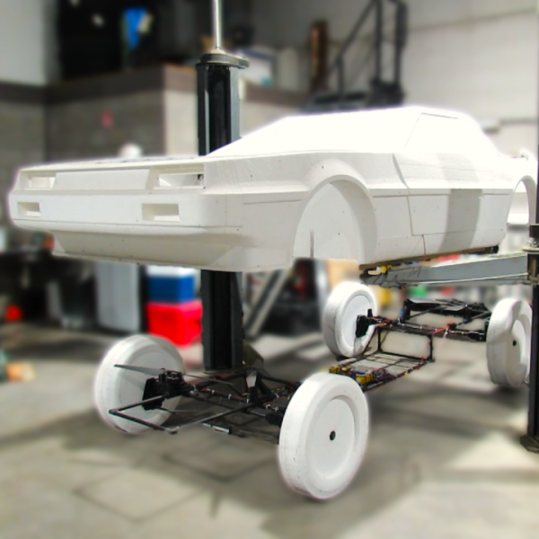

Well, the iconic gull-wing doors are still there, and still motorized, and they’ve been joined by a tire-tilting mechanism for a Back To The Future film-accurate flight mode. With the wheels down, the prop can use them to steer and drive, looking for all the world like an all-white DMC-12.
The aluminum frame we covered before is no longer in the picture, though. It’s been replaced by a lighter, stiffer version made from carbon fibre. It’s still a ladder frame, but now with carbon fiber tubes and “forged” carbon fiber corners made of tow and resin packed in 3D printed molds. There’s been a tonne of work documented on the build log since we last covered this project, so be sure to check it out for all the details.

It might be possible for further weight saving to drive the rear wheels off just one motor in the centre between the hubs and a carbon fibre tube going to each wheel hub gear mechanism. And further weight saving with just one motor to do the wheel tilt by using pulleys and fine kevlar cord.
I reckon advice from someone like Daniel on the rctestflight channel would be just the thing to tune the flight software to resolve the persistent yaw to the left.
Feels like you could save some of weight by putting battery packs near the motors and avoid all those long power cables?
