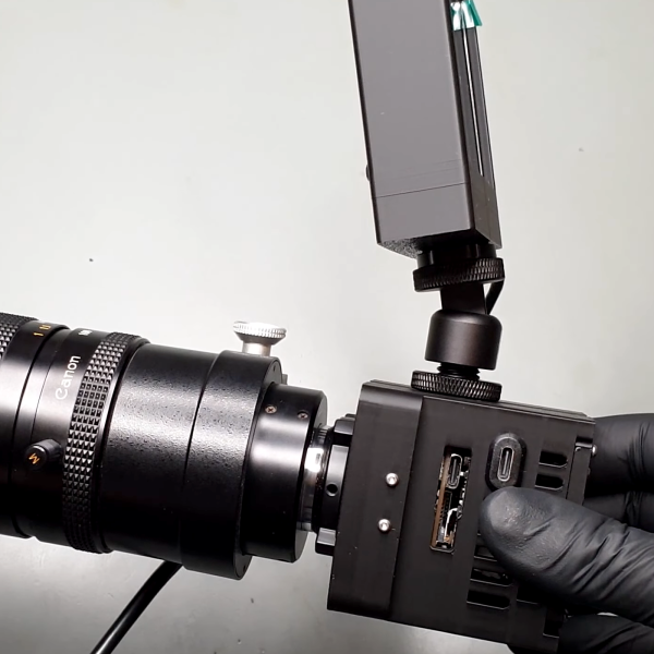

[Curious Scientist] has been working with some image sensors. The latest project around it is a 6K camera. Of course, the sensor gives you a lot of it, but it also requires some off-the-shelf parts and, of course, some 3D printed components.
An off-the-shelf part of a case provides a reliable C mount. There’s also an IR filter in a 3D-printed bracket.
The processor gets hot, so he used different heat sinks and a fan, too. Overall, this isn’t much custom electronics, but this is an excellent example of assembling existing parts with high-quality 3D printed components.
Heat-set inserts provide a tripod mount. There’s also a custom HDMI monitor mount if you don’t want to use your phone as a viewfinder. One neat oddity that helps is a USB-A cable that splits into three USB-C connectors. Of course, only one of them has data lines. The other two feed power to different parts of the camera.

        1. And who designed your house? Who made sure that the plumbing, the drainage, the electricity and everything else are built according to the code? Who did the calculations to make sure that the house won’t collapse under its own weight? These are all things that you cannot just buy in the department store.
          Similarly, my build also needed a lot of planning, design, labor and so on. The original camera kit is basically a small metal shell with the processor unit and the sensor unit wired to it. It is an FPV camera, so it is designed to be hacked into some other systems. Usually, it is an FPV drone, but since it has excellent video capabilities, I figured it is better to build a camera system around it with proper, standard attachments and considerations that could benefit people who want to do a similar transformation. As I explained in the article and video, the camera will be attached to my metallurgical microscope and it will also be used as a standalone “macro camera” with appropriate lens attached to it. So, that’s the motivation.

        2. For those who wish to read rather than complain, the linked article lists the motivation as breaking the cheap plastic lens threads that came on the original camera.
