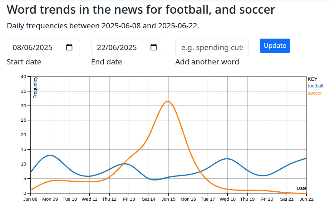

I think most of us who make or build things have a thing we are known for making. Where it’s football robots, radios, guitars, cameras, or inflatable textile sculptures, we all have the thing we do. For me that’s over the years been various things but has recently been camera hacking, however there’s another thing I do that’s not so obvious. For the last twenty years, I’ve been interested in computational language analysis. There’s so much that a large body of text can reveal without a single piece of AI being involved, and in pursuing that I’ve created for myself a succession of corpus analysis engines. This month I’ve finally been allowed to try one of them with a corpus of Hackaday articles, and while it’s been a significant amount of work getting everything shipshape, I can now analyse our world over the last couple of decades.

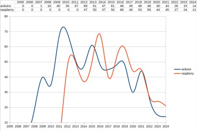

A corpus engine is not clever in its own right, instead it will simply give you straightforward statistics in return for the queries you give it. But the thing that keeps me coming back for more is that those answers can sometimes surprise you. In short, it’s a machine for telling you things you didn’t know. To start off, it’s time to settle a Hackaday trope of many years’ standing. Do we write too much about Arduino projects? Into the engine goes “arduino”, and for comparison also “raspberry”, for the Raspberry Pi.
What comes out is a potted history of experimenter’s development boards, with the graph showing the launch date and subsequent popularity of each. We’re guessing that the Hackaday Arduino trope has its origins in 2011 when the Italian board peaked, while we see a succession of peaks following the launch of the Pi in 2012. I think we are seeing renewals of interest after the launch of the Pi 3 and Pi 4, respectively. Perhaps the most interesting part of the graph comes on the right as we see both boards tail off after 2020, and if I had to hazard a guess as to why I would cite the rise of the many cheap dev boards from China.

The astute among you might wonder why the figures on the graph above are not higher, because surely we have featured more Arduino or Raspberry Pi projects than that. And here we touch on a problem faced by anyone working with data. It comes down to this: are we looking at spotting the trends from the data, or absolute figures? When I built this corpus, I had to make two choices, one over how much I was allowed to stress Hackaday’s infrastructure, and the other in how much computing power and physical storage space I was prepared to give the project on my bench. I lack a computing cloud for my work, instead I have to rely on silicon and spinning rust I own, and to that there’s a finite limit.
Thus in building this corpus I reasoned that the more important words pertaining to each story would be nearer the start, and restricted myself to the title and first paragraph of each Hackaday piece, or about a hundred words. It’s definitely enough for trend analysis, but for obvious reasons if the word you are looking for is way down in the third or fourth paragraph, you’ll be disappointed. Furthermore if this technique angers you, don’t look too closely at how your oscilloscope samples higher frequency waveforms.

From my experience with fragmented and sparse data: how are the graphs so smooooooth?

Graphs have humps that look like Gaussians to me, and probably represent a smoothing choice rather than the actual data. (It’s too smooth.)
I’d rather see it raw and jaggy.
I used LibreOffice Calc for most of it, and used the smooth line option.
