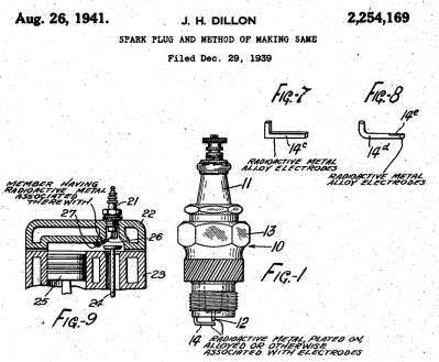

Firestone’s patent (US 2,254,169) came much later, granted in 1941. The company decided that polonium-210 was a more viable radioactive source. Radium was considered “too expensive and dangerous”, while uranium and thorium isotopes were found to be “ineffective.” Polonium, though, was the bee’s knees. From the patent filing:
Frequently, conditions will be so unfavorable that a spark will not occur at all, and it will be necessary to turn the engine over a number of times before a spark occurs. However, if the alpha rays of polonium are passing through the gap, a large number of extra ions are formed by each alpha ray (10,000 ions per-alpha ray) and the gap breaks down promptly after the voltage begins to rise and at a lower voltage value than that required by standard spark plugs. Thus, it might be said that polonium creates favorable conditions for gap breakdown under all circumstances. Many tests have been run which substantiate the above explanations. The most conclusive test of this type consisted in comparing the starting characteristics of many  polonium-containing spark plugs with ordinary spark plugs, all plugs having had more than a year of hard service, in several engines at -15° F. It was found that thirty per cent fewer revolutions of an engine were required for starting when the polonium plugs were used.
Firestone was quite proud of its new Atomic Age product. Credit: Firestone
As per the patent, the radioactive material was incorporated into the electrodes by adding it to the nickel alloy used to produce them. This would put it in prime position to ionize the air charge in the spark gap where it mattered most.
