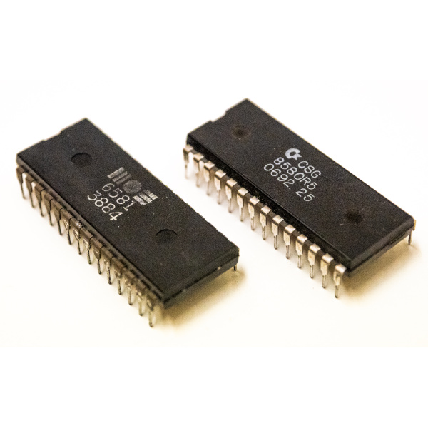

The MOS Technologies 6581, or SID, is perhaps the integrated circuit whose sound is most sought-after in the chiptune world. Its three voices and mix of waveforms define so much of our collective memories of 1980s computing culture, so it’s no surprise that modern musicians seek out SID synthesisers of their own. One of these is the MIDISID, produced by [MIDI IN],  and in a recent video she investigates an unexpected tuning problem.
It started when she received customer reports of SIDs that were out of tune, and in the video she delves deeply into the subject. The original SID gained its timing from a clock signal provided by the Commodore 64, with thus different timing between NTSC and PAL versions of the machine. This meant European SID music needed different software values to American compositions, and along the way she reveals a localisation error in that the British Commodore 64 manual had the wrong table of values.
Modern SIDs are emulated unless you happen to have an original, and her problem came when switching from one emulated SID to another. The first one used that clock pin while the second has its own clock, resulting in some music being off-tune. It’s a straightforward firmware fix for her, but an interesting dive into how these chips worked for the rest of us.

  1. One of the SIDs in my 13 C64s also has a slight defect where one of the voices occasionally plays sour notes – out of tune by up to a note and a half. I need to use the SID test program on it and see if there’s irregularities in the sweep on one voice. Kinda odd that this only happens every now and again and only on some tunes, but at least it’s reproducible.
    (I also have two where if you use Attack on voice 1, that voice disappears completely – that’s also only noticeable on some tunes)
    1. The SIDs were very fragile to begin with, I think.
      I guess they could take damage when joysticks/paddles weren’t okay?
      The X/Y pins on the joystick ports connected to the SID and were used for paddle and analog mouse support.
      Also, the filters..The first type, the 6581, technically was broken but games/demod were programmed for the flaw(s),
      thus did sound wrong on later versions that were fixed.
      Then there’s that a** poor Commodore power supply of the C64, the early elephant foot type.
      It provided overvoltage not seldomly and likely stressed or even damaged the C64 components.
      Maybe it caused SID chips to fail, too. Not sure.
      1. The power supply has probably broken more C64s than any other fault. Since it is potted in epoxy, hard to tell what is the actual problem, but I suspect the resistor in regulators ground connection. It was added to slightly raise the output voltage. After all these years, the power supply raises its +5V to almost 6 volts while warming up.
        I have installed a zener/thyristor crowbar limiter to all my Commodore machines, to short out the power supply and blow fuse when 5V goes above 5.5V. With old C64 power supplies, that happens surprisingly often.
