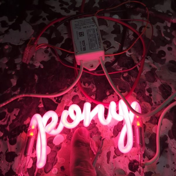

We typically think of neon signs as big commercial advertisements, hanging inside windows and lofted on tall signposts outside highway-adjacent businesses. [James Akers] has gone the other route with a fashionable build, creating little wearable neon necklaces that glow beautifully in just the same way.
Aiming for small scale, [James] began with 6 mm blue phosphor glass tube, which was formed to reference Pink Pony Club, one of Chappell Roan’s more popular songs. The glass was then filled with pure neon up to a relatively low pressure of just 8 torr. This was an intentional choice to create a more conductive lamp that would be easier to run off a battery supply. The use of pure neon also made the tubes easy to repair in the event they had a leak and needed a refill. A Midget Script gas tube power supply is used to drive the tiny tubes from DC power. In testing, the tubes draw just 0.78 amps at 11.8 volts. It’s not a light current draw, but for neon, it’s pretty good—and you could easily carry a battery pack to run it for an hour or three without issue.

    1. the High voltages were managed with silicone “boots”. They are the best insulators. The wires coming off the midget are the pvc wires and not the nice silicone ones. Despite all this, none of the four of us received a shock…. even as it poured rain in the concert.
      Not necessarily saying you should go do this on your own, as I have a bit of experience with neon, but it is (surprisingly) possible :)

      In this case, the 7 torr fill is less than 1% atmospheric pressure- so its super conductive. Even in the rain, none of us felt any current on our bodies. The neon was more conductive than the path to ground through wet wire and us- so the electricity just stayed going through the tube.

  3. Not to be a killjoy , but from a safety standpoint, this just sounds like a bad idea. Zooming on the provided links show a power supply capable of 5KV @ 20ma. Standard GFCIs trip at 4-6ma. 9w of power to a small area like that would also be quite warm. That and jumping around at a concert with delicate glass around your neck….
    Maybe use LED flexible filament instead? Looks like it can be found in multiple colors on ebay. More efficient, smaller battery pack needed, and likely more resilient. I understand the look wouldn’t be as cool as actual neon, but from a practicality standpoint I wouldn’t gamble with glass.
    1. Thank you for your concerns. It rained at this concert actually and the neon was fine throughout the evening. No zappy’s to my neck despite my non outdoor installation :) Yeah its 5kv, but this is far from my first wearable neon rodeo, and I actually turned the midget transformer current down a bunch for its concert brightness.
      As a professional neon maker, the LED wire would take me longer to make and fix so its rigid. Its actually more work for me for a result that just isn’t as eye catching in the end. Sure its fragile, but none of the four I made for my friends broke in the evening. I broke two of them from my own carelessness, (dropping them from my messy desk)- but was able to just splice in a new section and repump them.
