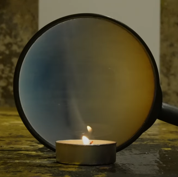

A magnifying glass is seen behind a small tea candle. The magnifying image is projecting the shadow of a column of heated air.
Perhaps the most surprising thing about shadowgraphs is how simple they are: you simply take a point source of light, pass the light through a the volume of air to be imaged, and record the pattern projected on a screen; as light passes through the transition between areas with different refractive indices, it gets bent in a different direction, creating shadows on the viewing screen. [Degree of Freedom] started with these simple shadowgraphs, moved on to the more advanced schlieren photography, and eventually came up with a technique sensitive enough to register the body heat from his hand.
The most basic component in a shadowgraph is a point light source, such as the sun, which in experiments was enough to project the image of an escaping stream of butane onto a sheet of white paper. Better point sources make the imaging work over a wider range of distances from the source and projection screen, and a magnifying lens makes the image brighter and sharper, but smaller. To move from shadowgraphy to schlieren imaging, [Degree of Freedom] positioned a razor blade in the focal plane of the magnifying lens, so that it cut off light refracted by air disturbances, making their shadows darker. Interestingly, if the light source is small and point-like enough, adding the razor blade makes almost no difference in contrast.
With this basic setup under his belt, [Degree of Freedom] moved on to more unique schlieren setups. One of these replaced the magnifying lens with a standard camera lens in which the aperture diaphragm replaced the razor blade, and another replaced the light source and razor with a high-contrast black-and-white pattern on a screen. The most sensitive technique was what he called double-pinhole schlieren photography, which used a pinhole for the light source and another pinhole in place of the razor blade. This could image the heated air rising from his hand, even at room temperature.

  1. Thanks for the insight into this interesting technology. Your penultimate setup is closer to a telecentric backlight than to a schlieren optic, in my opinion. Or to koehler illumination as used in microscopes.
  2. Okay the part with picking up hand heat at 70 degrees room temperature was very impressive, I audibly said wow to that one.
  3. One thing though, the sun can not ‘be seen as a perfect pin source’, in fact the sun is seen as perfectly parallel rays. It’s very far away and very very big you see.
    (Or actually, you don’t ‘see’ it as it is and thus the confusion :))
