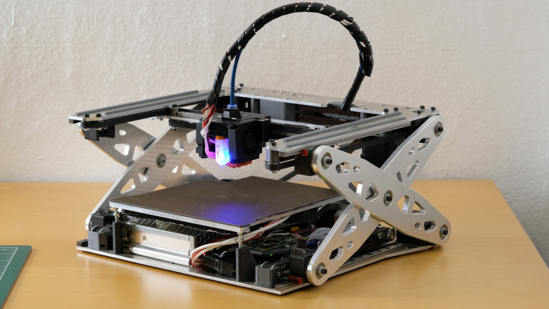

We don’t know about you, but one of the biggest hassles of having a 3D printer at home or in the ‘shop is the space it takes up. Wouldn’t it be useful if you could fold it down? Well, you’re in luck because over on Hackaday.io, that’s precisely what [Malte Schrader] has achieved with their Portable CoreXY 3D printer.
The typical CoreXY design you find in the wild features a moving bed that starts at the top and moves downwards away from the XY gantry as the print progresses. The CoreXY kinematics take care of positioning the hotend in the XY plane with a pair of motors and some cunning pulley drives. Go check this out if you want to read more about that. Anyway, in this case, the bed is fixed to the base with a 3-point kinematic mount (to allow the hot end to be trammed) but is otherwise vertically immobile. That bed is AC-heated, allowing for a much smaller power supply to be fitted and reducing the annoying cooling fan noise that’s all too common with high-power bed heaters.
Both ends of the cable bundle are pivoted so it can fold flat inside the frame!

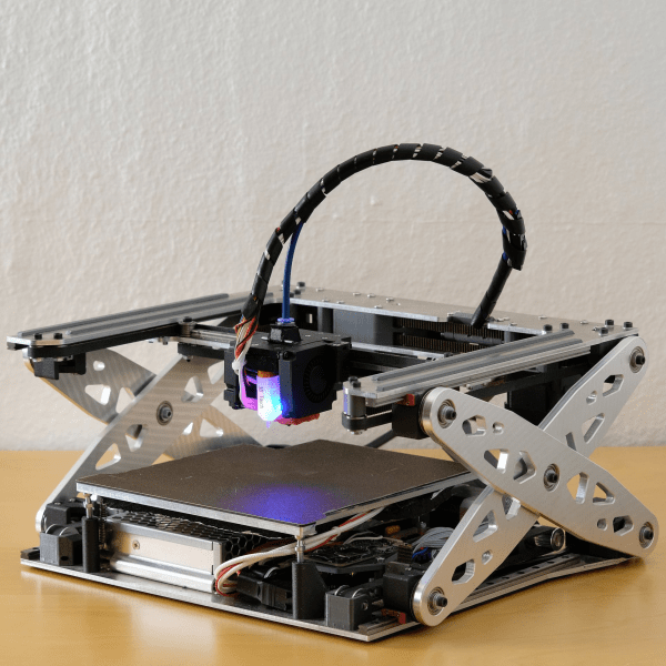

The XY gantry is mounted at each end on a pair of scissor lift mechanisms, which are belt-driven and geared together from a single stepper motor paired with a reduction gearbox. This hopefully will resolve any issues with X-axis tilting that [Malte] reports from a previous version.
The coarse tramming is handled by the bed mounts, with a hotend-mounted BLTouch further dialling it in and compensating for any bed distortion measured immediately before printing. Simple and effective.
As will be clear from the video below, the folding for storage is a natural consequence of the Z-axis mechanism, which we reckon is pretty elegant and well executed—check out those custom CNC machine Aluminium parts! When the Z-axis is folded flat for storage, the hotend part of the Bowden tube feed is mounted to a pivot, allowing it to fold down as well. They even added a pivot to the other end of the cable bundle / Bowden feed so the whole bundle folds down neatly inside the frame. Nice job!
If you want a little more detail about CoreXY kinematics, check out our handy guide. But what about the H-Bot we hear you ask? Fear not, we’re on it.

  1. This is brilliant. There are a lot of appliances that compete for space and this could fit in a drawer. Maybe a bellow for an enclosure and then it would fit the needs of a lot more people.
    1. It can be quite stable (see chem/physics laboratory liftboys) but this thing seems to use belts to move scissor endpoints.
      I’d have expected screws (with maybe a single motor driving both via a single belt) – this would be inherently stiffer I think (maybe with flat bearings at all screw shaft endings).
    2. That would be my concern – those centre bearings are doing a lot of work.

    The best way to fix the X-Y wobble (also mentioned by Henrik above) is to connect the left side and the right side of the scissors together.
    1. Interesting side point from the original that z-axis position has a sin(x) relationship to the stepper input.
      That gives you the highest load and worst precision at the start of the print, which isn’t ideal since that’s the part that’s guaranteed to be present on all prints. You can mitigate it a bit in the design by limiting how far you fold and gearing down the z-axis, but I don’t see a way to eliminate that weakness.
      1. I’ve toyed with that problem a bit, imo it can be dealt with by over-constraining the scissor mechanism (see link below). That way the precision is best around both extremes, especially at the start of the print… but it sure bumps cost and complexity. Bonus is that it’s stiff and guaranteed to be free from slop.
