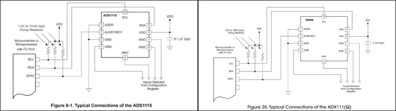

Regarding the cheapo parts off Amazon, these could be QA failed parts, ‘third shift’ or other grey zone parts being sold for less, as well as outright fakes. The Analogy ADX111 for example is basically a drop-in clone of the ADS1115, down to parts of the datasheet, with the heading image showing a section to compare the two. Interestingly, the ADX111 is sold for $1.77 in 1,000 quantities on LCSC.
