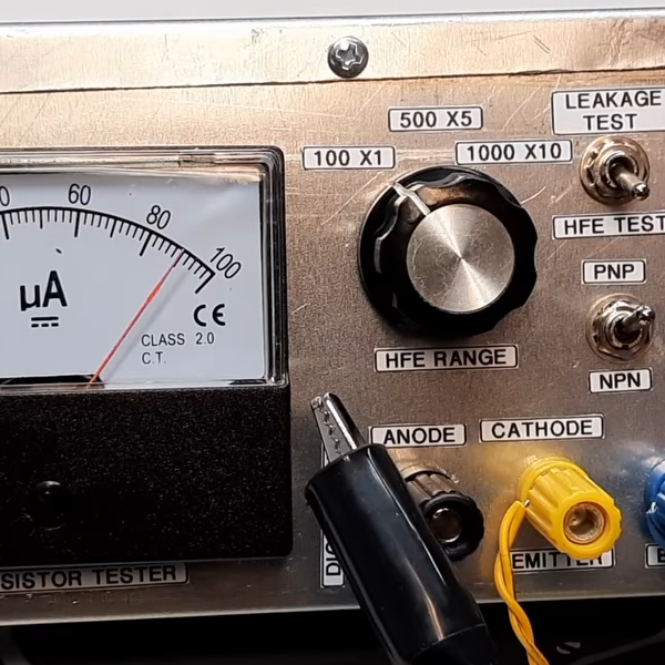

[Bettina Neumryr] thinks so. She has a hobby of finding old magazine projects and building them. Her most recent installment is a transistor tester from the June 1983 issue of Everyday Electronics.
The tester was quite a neat job for 1983, with a neat case and a PC board. It measures beta and leakage. There’s an analog meter that can measure the collector current for a fixed base current (beta or hfe). Leakage is how much current flows between emitter and collector with the base turned off.
In 1983, we’d have loved to have a laser printer to do toner transfer for the PC board, but of course, that was unheard of in hobby circles of the day. The tester seemed to work right off the bat, although there was a small adjustment necessary to calibrate the device. All that was left was to put it in a period-appropriate box with some printed labels.

  3. The test voltage is only 3.5V for the transistor being tested. No good for me, I am at 40V for matching diff amp transistors in audio power amp, mic preamp front-ends etc.
    If it had a boost-converter then I would build it.

  6. Interesting math in the video: “twelve times five is a hundred and ten”.
    I have estimated something like 60 for 12*5, but what do I know?
    So the readings for the second Germanium transistor are actually relatively consistent in my world.
