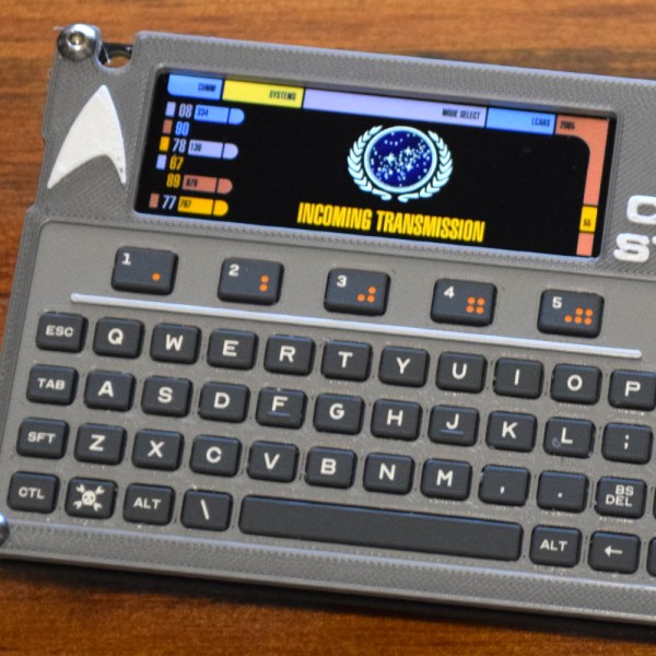

This year’s badge is unique among Supercon badges because it isn’t just a PCB. It’s actually a stack-up of two PCBs! That might not sound like much of a distinction, but in this case, the front board has no electrical function — its only purpose is to hold the keyboard membrane against the dome switches on the rear PCB. The only reason we made it out of a PCB in the first place is that it was convenient and cheap at the scale we needed. But if those weren’t concerns, it could just as easily have been 3D-printed or cut out with a laser or a CNC router.
While the necessities of running two hacker cons on opposite sides of the planet within a couple of months of each other meant we needed to think at scale, attendees are free to do whatever they want between now and when they get their badges on Friday. Want to carve a front panel out of aluminum on your CNC? Awesome. Perhaps laser-cut some thin plywood and give it a nice stain for that old-school look? We love it. Want to see what that fancy multi-material 3D printer you’ve got is capable of? So do we.
Hailing frequencies open, Captain.
