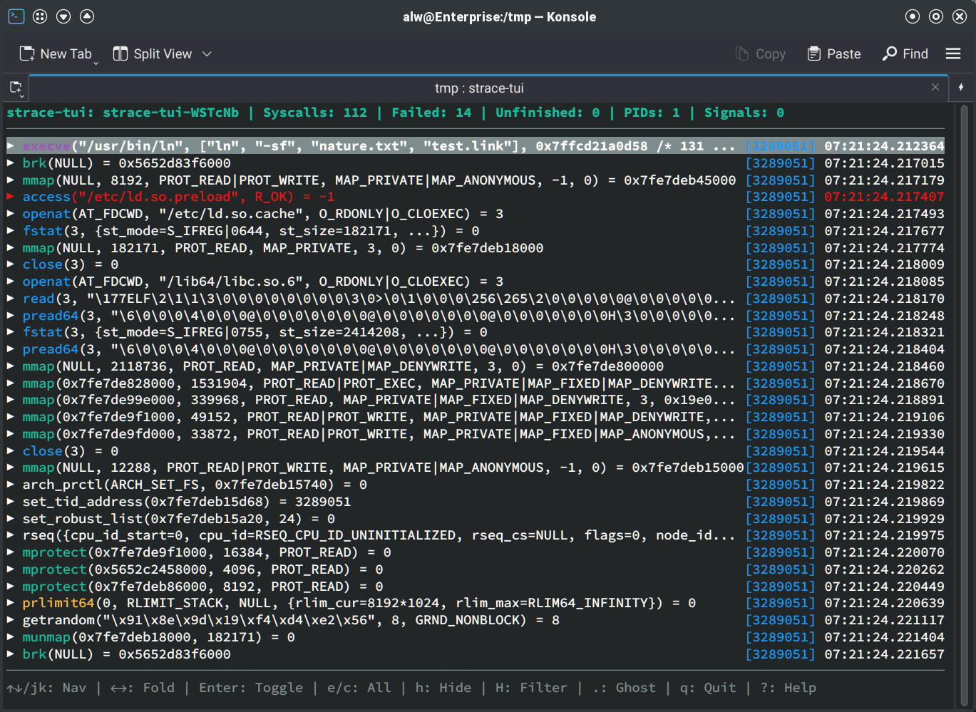

The strace-tui interface.
The only issue I had running the tool was that I don’t normally keep ~/.cargo/bin on my path. You can add it to your path, link the executable into your path, or solve that in any number of other ways.
As an example, I traced a symbolic link command (ln -sf nature.txt test.link). It is easy to pick out some essential information on the top line. The command took 112 system calls, 14 of them failed (which isn’t unexpected), there were no unfinished calls, no signals, and only a single PID.
The bottom shows things you can do. Arrows or j and k, along with the usual cursor control keys like Home and Page Down scroll through the list. The right and left arrows will expand or collapse items. That will show details about the call in question, including the arguments and return values. You can consult the help for all the details.

The real power, though, lies in filtering out the noise and searching for specific things. If you are looking at something you don’t want to see, you can press a lowercase h to hide it, but note that it hides everything similar, not just an individual line. An uppercase H will bring up a filter dialog where you can include or exclude groups of data.
Searching is also a great way to find what you want. A slash key starts a search. The N key navigates with a lowercase entry moving forward and an uppercase one moving backward.
For example, if I only wanted to look at openat commands, I could open the dialog. Not only does it show filters, but it also shows how many things match (there are 30 instances of openat). Pressing a will toggle all entries off and then selecting openat greatly reduces the amount of output. I also selected symlinkat,  read, and fstat so I would only look at the file-related items.

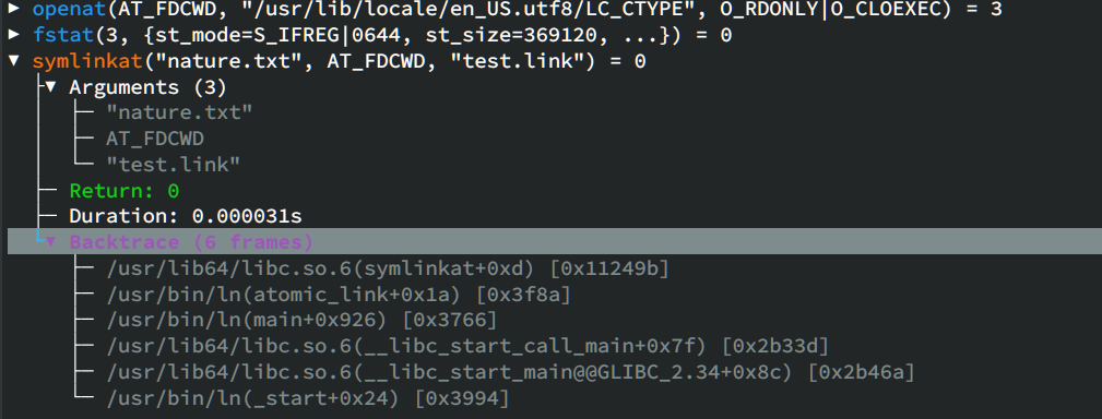

Peeking at the system call that does the actual linking.
Many of the file operations are related to loading shared libraries and locales. To find the actual line that makes the link, it was easy to press the slash key and some text from the file like test.link.
That will highlight the symlinkat line, which is no surprise, but this is a simple example. If you press Enter or the right arrow, you can see more detail, including arguments, the return value, the amount of time executing, and a backtrace that shows how your program made it to the call.
