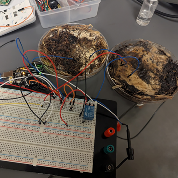

Fungi make up a massive, interconnected part of Earth’s ecosystems, yet they’re vastly underrepresented in research and public consciousness compared to plants and animals. That may change in the future though, as a group of researchers at The Ohio State University have found a way to use fungi as organic memristors — hinting at a possible future where fungal networks help power our computing devices.
A memristor is a passive electronic component whose resistance changes based on the voltage and current that has passed through it, which means it can effectively remember past electrical states even when power is removed. To create these circuit components with fungus, the researchers grew shiitake and button mushroom mycelium for these tests, dehydrated their samples for a number of days, and then attached electrodes to the samples. After misting them briefly to restore conductivity, the samples were exposed to various electrical wave forms at a range of voltages to determine how effective they were at performing the duties of a memristor. At one volt these systems were the most consistent, and they were even programmed to act like RAM where they achieved a frequency of almost 6 kHz and an accuracy of 90%.
In their paper, the research group notes a number of advantages to building fungal-based components like these, namely that they are much more environmentally friendly and don’t require the rare earth metals that typical circuit components do. They’re also easier to grow than other types of neural organoids, require less power, weigh less, and shiitake specifically is notable for its radiation resistance as well. Some work needs to be done to decrease the size required, and with time perhaps we’ll see more fungi-based electrical components like these.

  3. Cool idea + use of MCU is fantastic and novel but there are already a bunch of papers on this. I have some engineering considerations that might help figure out if the memristor effect is actually real. Lets look at the details and also building on previous work limitations:
    Memristive frequency response is 25 Hz then vanishes. Verdict: not a high frequency memristor and appears to be electrochemical macroscale phenomena
    Resistance switching experiments use an MCU. The high frequency effect is measured via the speed of the mechanical relay. No stimulus artifact removal outlined. Verdict: electrochemical/electrode polarisation phenomena
    The effect is apparent even if the mushroom is alive or dead. Verdict: electrochemical/electrode polarisation phenomena
    So what are we left with, if true?
    New ionotronic material that is rehydratable but not a biocomputing device?
    However, it is absolutely not biocomputing because no electrophysiological aspects of the fungus were used. If you think this is viable as a biocomputing technology I encourage you to test in the following format:
    Microscale electrodes
    Position proximal to the fungal hyphae clusters
    Test at a wide frequency response range (1 Hz-10 kHz)
    Is the effect retained across frequencies and scales in the experiment?
    We need to really test this kind of stuff before going the whole hog on a barage of press releases.
  4. Hmmm…the memristive effect is only apparent at 25 Hz. Then vanishes. Resistance switching with MCU is cool but a different type of experiment that is subject to lots of macroscale electrochemical effects due to the size of the electrodes and media. There are a couple of recent papers that use the dead matrix and associated electrochemical effects. Ok, but it is not biocomputing – e.g. what part of physiology is being put to use here-! Main question (and also for previous fungal memristor papers): Why would the memristor be apparent in the MCU experiment at that high frequency if the IV curves show that it disappears at 25 Hz? Isn’t this is a demonstration of a low frequency memristor effect with a separate experiment with the MCU? What about stimulus artifacts?
