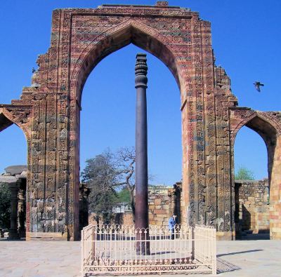

The Iron pillar of Delhi, erected around 400 CE. (Credit: Sujit Kumar, Wikimedia)
So how did medieval iron alloys differ from that during the early days of the Iron Age in Europe and China, never mind during the technological boom of the ancient Roman Empire? Unsurprisingly the Early Middle Ages (500 – 1000 CE) saw mostly a sharp decline in mining and metallurgy that took until the High Middle Ages (11th to 13th centuries) to begin to recover and the Late Middle Ages to see a strong push for innovation. This was however not an easy period, as famine, war and pestilence kept ravaging economies and its people. Compared to the relative peace and structured society of the Roman times, things couldn’t have been more different.
The study of metallurgy from a historical context is called archaeometallurgy, which focuses on observable evidence such as slag and similar residues left over at former furnace and blacksmithing sites, as well as found metal artefacts. This latter aspect of found artefacts bears reminding, as these include the iron objects that survived often being buried for hundreds if not thousands of years. This risks indulging in survivorship bias, as we do not recover iron artefacts that did rust away, nor those that were tossed with other scrap metal into a furnace.
The iron pillar of Delhi is one such example. This six-ton, 7.21 m tall behemoth has drawn significant attention for its lack of corrosion despite having been exposed to the elements for more than a thousand years. After study of this pillar and other examples of Indian iron from roughly the same era, the levels of phosphor (P) were implicated in the formation of a corrosion resistant hydrate layer, as summarized in a 2000 article by R. Balasubramaniam in Corrosion Science. This is however a relatively thin and fragile layer. Before a protective cage was added, the constant touching of visitors would affect this layer, explaining why its bottom is rather rusty.
What this does however highlight is the importance of a passivation element in iron alloys to enable some level of corrosion resistance by preventing or slowing down the oxidation process. This, combined with environmental factors such as dry air and a low-oxygen environment can be key to the survival of an iron object.

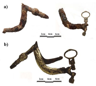

Spanish medieval gilded spur. 13th - 15th century. (Credit: Marco Veneranda, 2016)
Spanish medieval gilded spur. 13th – 15th century as found (a) and preserved (b) (Credit: Marco Veneranda et al., 2016)
In the case of modern stainless steel, this passivation is provided primarily by chromium which helps form a protective layer. As pre-Industrial Revolution iron alloys tended to have significant amounts of slag and other contaminants embedded in them, this provided enough opportunities for such a passivation layer to be formed.
A good study subject when it comes to medieval iron can be found in the surviving medieval structures, which are primarily churches and cathedrals. These have iron reinforcements that are exposed to various environments, ranging from an dry indoor climate to ones more conducive to corrosion. In a study of these iron rebars in the 13th century Bourges’ Cathedral attic, including a broken one, it was found that they were decidedly rusting away and that even these primarily indoor rebars need special preservation techniques to keep them from eventually failing.
During an excavation in a medieval necropolis in Spain, a gilded spur was uncovered. This was used for an experimental archaeological analysis method, detailing just how far this gilded, medieval iron object was decayed. While the gold layer provided some protection against corrosion, eventually moisture and oxygen managed to make its way past this layer and over the course of a few hundred years much of the spur decayed to the point where it was largely falling apart.
