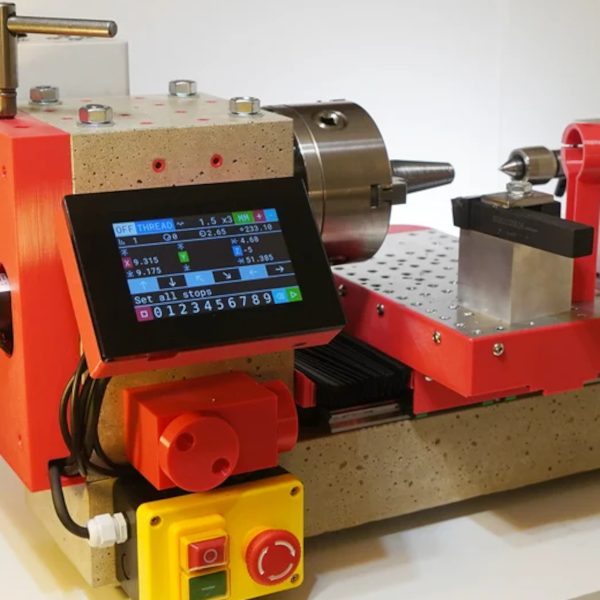

Concrete Lathe Turns Metal
Full disclosure. If you want a lathe capable of turning metal stock, you probably should just buy one. But what fun is that? You can do like [kachurovskiy] and build one with your 3D printer. If you are chuckling, thinking you can’t make 3D printed parts sturdy enough, you aren’t exactly wrong. [Kachurovskiy’s] trick is to 3D print forms and then cast the solid parts in concrete. The result looks great, and we don’t doubt his claim that it “can surpass many comparable lathes in rigidity and features.”
Even he admits that this is a “… hard, long, and expensive project…” But all good projects are. There’s a GitHub page with more details and informative videos below. The action shots are in the last video just before the six-minute mark. Around the seven-minute mark, you can see the machine cut a conical thread. Color us impressed!
The idea of casting concrete with inserts in it is giving us a number of ideas. We haven’t done it before, but it looks like a good skill to learn. You can 3D print concrete, too. Concrete lathes are, surprisingly, not a new idea, but much harder to do without 3D-printed forms.

  1. we don’t doubt his claim that it “can surpass many comparable lathes in rigidity and features.”
    The elastic modulus of concrete is between 20-40 GPa which is much bendier than aluminum. It’s pretty much “cheese” compared to metals – casting the frame out of plain tin would make it more rigid. You can expect twice the amount of flex compared to aluminum, but you can easily compensate for the lack of rigidity simply by making the load bearing sections twice as wide in the direction of bending or compression. This however does mean the whole structure will weigh about twice as much as an equivalent aluminum frame.
    As for the cracking problem, there was a recent Practical Engineering video about concrete structures. The video pointed out that typical concrete reaches about 75% of its nominal strength in 7 days and 90% in 28 days. If you try to clamp it down right after pouring, it will just crumble like that.
    Concrete structures seem really rigid and strong to the casual observer, but they’re really not – it’s just because the typical structures are so massive that the flex becomes basically invisible to the naked eye. If you made the structure small and light enough to bend by human force, to experience the bending yourself, it’d likely just break. This lack of rigidity however isn’t a negative point for concrete: it can tolerate and conform to deformation, like ground shifting underneath a building.
    1. And looking at the scale of that concrete casting it probably is stiffer than most similarly sized lathes, at least in the bed, slightly less convinced around the spindle and wonder how good those linear rails really are (as that will have a huge impact). But as being heavier for a machine tool is only ever a good thing – you put an excentric mass like a cam being machined on your lathe and if it isn’t really really heavy or bolted to something that is it will move on you, potentially quite fast! Might not make any difference to the machining quality if the machine is stiff but a bit light, but it will move. As I know quite well from my little watch makers lathe – its a really stiff machine for its size anyway, and even with a rather chunky cast baseplate it will happily try to walk spinning an off balance mass.
      So it really doesn’t matter how much material you end up using and how massive it is, the cost, ease of production and suitability for the use environment. And there is no doubting that cast concrete is both suitable and much easier for most folks to do, especially with a 3d printed formwork than the foundry work to cast in even the usually softer lower point melting metals.
      For myself I can’t see why you’d make a cast concrete machine in most places in the world, as restoring an old iron machine is likely just as much of an adventure and almost certainly gets you a better end result as those old iron machines are the product of many years of evolution to a good machine and no doubt have thousands of handy accessories made to fit so you don’t have to re-invent the wheel all the time (but obviously can if you want to). And if you really need to make your own for some reason fabricated metal structure with epoxy granite infill type concepts seems rather more flexible, likely quicker and will give a good result. But still I like this project, its interesting making use of off the shelf stuff like the linear rails etc.
      1. looking at the scale of that concrete casting it probably is stiffer than most similarly sized lathes
        That would be because most “similarly sized lathes” would be made of mostly hollow extrusions. Less material, less cross-section area, less rigidity.
        If you made the same frame out of solid aluminum, it could be half as thick or even less – if so desired. However, the concrete has an advantage over aluminum in the fact that it’s not a homogeneous material. It has density differences between the cement and the gravel and sand, so it absorbs vibrations orders of magnitude better. Weight and size does matter though. Just moving them around becomes a problem, and your machine table has to support the weight.
        The point of making a cast concrete lathe is that you don’t need much machining to do it. You don’t need any welding or milling or other fine metal shaping. If you can nail a few boards or glues some plastic together, you can make the forms, so it’s much more accessible to your average garage maker, and if done right it will be superior to your average hardware store or kit built lathe.

      2. at least in the bed, slightly less convinced around the spindle
        I have the opposite take. The spindle bearings have plenty of material around them in the chunky tower, which distributes the load and keeps it rigid, whereas the bed is a long thin piece that would be more susceptible to flex.
        It all goes down to leverage – twice the distance doubles the bending stresses. If you’re turning a longer piece, pushing the cutting tool against the work is more likely to bend the bed than the spindle tower simply by how far away it is, but also because the tower is so much thicker in the direction of bending.
        1. It is mostly the vertical direction on the spindle and it being concrete that makes me a little dubious – that top part is not very thick, more inline with a metal casting above the bearings, and honestly not that vast around the sides either – being square its got more mass than the usually more form fitting metal casting, but those corner part just are not all that structurally relevant, that is all on the thinnest point on the walls where the bearing go though..
          Where that bed is really really massive compared to a metal bed casting. Leverage matters but so does so many other factors from how direct the force paths can be, and how much of the material is involved in dealing with any particular load. So as this is a solid brick of concrete that is huge compared to the usually quite hollow metal casting where each rail of the bed is only joined by a handful of webs.
          I don’t think this is a bad machine by any stretch, but when comparing to a more normal lathe the spindle mounts walls are pretty thin at the thinnest points, so considering its made in a comparatively poor material that is the point it likely doesn’t stand up so well in comparison. Where the bed is much more substantial all round than the normal metal castings being practically a solid brick of significantly thicker dimensions all round than the similar length and bed spaced metal one – so assuming the linear rails and their mounting is up to it the bed should perform really well, I’d not be shocked if its able to perform rather better than the majority of metal castings despite the less capable material choice as its huge!
          1. If you’re worried about the thin arch above the bearing, that is easily remedied by a sideways metal bar between the threaded rods above the bearings.
            This is the source of the cracking issue as well. As the bearing tries to lift up, it spreads the top arch apart sideways and that causes the concrete to crack. Putting a rod or a bar sideways through the top would eliminate the chance. The fact that the concrete doesn’t crack in the latest iteration means that the tension forces on the arch are not that great.
          2. Indeed, or you could thicken the side walls up so there is more material resisting it stretching open at the top, or any number of other fixes that would make it better. If its actually needed, which it might be – just because the concrete hasn’t visibly cracked doesn’t mean its not still flexible enough to make a difference, cracking is a rather complete and visible failure, but that doesn’t mean no cracks is actually a measure of good enough.
          3. just because the concrete hasn’t visibly cracked doesn’t mean its not still flexible enough to make a difference
            The tensile strength of concrete is pretty much 1 MPa, which is 1 N/mm^2 or the equivalent load of 10 kilos suspended from a 1 cm thick bar of concrete. It’s basically nothing. To put that into perspective, let’s say the Young’s Modulus E=20 GPa, which would mean that the proportional stretch s

    2. The only complaint about the build itself that I have: The motor mounting bracket will creep as the motor gets warm. It’s too flimsy. This is an easy fix by bending it out of aluminum instead.
      Make note that he used metal threaded inserts at the ends of the plastic inserts inside the concrete. This is very good – this anchors the screws to the concrete. Other youtubers doing concrete frames have omitted this feature. Ideally you would use a metal bar with threaded holes to give it more surface area to grab hold of the concrete and spread the load to give it more rigidity, but this is still much better than plain plastic inserts or plastic inserts with metal inserts pressed in – because again, plastic will creep and the threads or the inserts would pull out. You need the plastic around the hole to act as “grouting” to prevent the concrete from cracking, but the metal insert is what keeps the tension – the plastic won’t.
