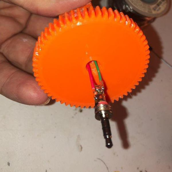

If you’re familiar with electrical slip rings as found in motors and the like you’ll know them as robust assemblies using carefully chosen alloys and sintered brushes, able to take the load at high RPM for a long time. But not all slip ring applications need this performance. For something requiring a lot less rotational ability, [Luke J. Barker] has something from his parts bin, and probably yours too. It’s an audio jack.
On the face of it, a 1/4″ jack might seem unsuitable for this task, being largely a small-signal audio connector. But when you consider its origins in the world of telephones it becomes apparent that perhaps it could do so much more. It works for him, but we’d suggest if you’d like to follow his example, to use decent quality plugs and sockets.

    1. It works OK but if you have low signal or something you have to be careful with how fast you spin it. Its a real easy way to add noise to your signal. That said it is the cheapest slip ring I know of.
    2. I’d idly wondered about if for a while, some model makers told me it works ok for “low spec” uses. Apparently common in things like R2D2 models to get power to the rotating head part. Data goes over IR. They do wear out.
      So I made a Ferris wheel. Wheel spun on an axle, plugs were inside so there was no load on them. One each side for redundancy. Powered some LEDs on the baskets. Worked fine. Might still be working.
      I wouldn’t use that for addressable LEDs, slips rings are pretty noisy and I presume these would be much worse.
      To be honest you could bodge up some DIY slip rings that would work just as well or better, but the phono jack is worth keeping in mind.
  1. Now that’s some quality abuse. It’s kinda terrible–I’m sure the plating will wear right off if you spin it for very long–but clever and functional within its limitations.
      1. Unless you put a lot of DC current through, because the single point contact will arc and erode quickly. An audio jack doesn’t make a good power connector anyhow.
  2. It’s a pretty good idea for low total rotations and speed and, I’d imagine, high noise tolerance.

  4. It probably helps if there’s a bearing or some other mechanical bit for retention because twisting an audio plug is a great way to get it to pop out of the socket.

  5. About twenty years ago, I was playing around with robotics. I built a tracked robot (thanks Tamiya!) based on an RTX2000 (Forth CPU) evaluation board. I placed a collision avoidance sensor (IR LED pair) on a turret. It was rotated with a stepper motor to provide spaced rotation steps. A magnet and Hall effect sensor were used to provide a reference point while rotating. To get power, ground, and two data signal outputs to the turret, I used a telephone cord detangler as a slip ring. It worked quite well for a slow rotation, low current application.
    1. Phone detanglers are great. They are small and have a couple of contacts. In case you need to transmit high power – there’s a slip ring in the cable wind up mechanism of your old vacuum cleaner.

  6. This summer just gone, I did just that. We had a 120-metre cable on a winding drum, but it needed to be connected to a datalogger. Solution: I used a ¼” jack and socket – the socket was on the drum and the jack plug on the connecting cable between drum and datalogger. Worked a treat 😁
  7. i have done this with quarter inch in a very low rpm and intermittent situation. works very well, but agree that longevity would be an issue if it was really having to spin long term. i was running audio, so low voltage and current, didn’t have as much problem with noise as i was expecting, but there was occasionally something
  8. I used a 1/4 inch plug/socket for this idea for a ’round the pole’ 12v planes in the 90’s. (Think 20cm wingspan balsa plane tethered to a weighted pole with the tethers being the voltage lines, slight up elevator and the motor speed controlled – more rpm = more height (ish).)
