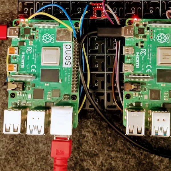

If you want to protect a system from being hacked, a great way to do that is with an airgap. This term specifically refers to keeping a system off any sort of network or external connection — there is literally air in between it and other systems. Of course, this can be limiting if you want to monitor or export logs from such systems. [Nelop Systems] decided to whip up a simple workaround for this issue, creating a bespoke one-way data extraction method.

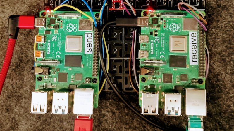

The concept is demonstrated with a pair of Raspberry Pi computers. One is hooked up to critical industrial control systems, and is airgapped to protect it against outside intruders. It’s fitted with an optocoupler, with a UART hooked up to the LED side of the device. The other side of the optocoupler is hooked up to another Raspberry Pi, which is itself on a network and handles monitoring and logging duties.
This method creates a reliable one-way transmission method from the airgapped machine to the outside world, without allowing data to flow in the other direction. Indeed, there is no direct electrical connection at all, since the data is passing through the optocoupler, which provides isolation between the two computers. Security aficionados will argue that the machine is no longer really airgapped because there is some connection between it and the outside world. Regardless, it would be hard to gain any sort of access through the one-way optocoupler connection. If you can conceive of a way that would work, drop it down in the comments.

  3. I’m all in favor of HaD taking up the mantle of 2600 magazine, so this isn’t a complaint, but obviously this does defeat the (questionable) concept of an air gap, which is to make access physically impossible.
    There could be information leaked in the log data or a side channel that was supposed to be secret, or perhaps could be used to acces the Raspberry Pi through the wifi interface that it has, and from there access the target system, etc. It’s unlikely, but you can’t rule it out, and then why not just make life easier by networking the thing and hoping your firewall is up to the job?
      1. Even more pedantic perhaps, but most optocouplers I’ve cracked open are actually an epoxy moulding around a solid lump of some sort of optical plastic so there’s no air inside them.
    1. If this optocoupler setup breaks the air gap, then so does attaching a monitor to the machine does so as well. Heck, by your logic, if a computer has any way to affect the outside world (i.e do anything), then it isn’t air gapped.
      1. Yeah, that’s why I say the whole concept of an air gap is questionable. A system is either provably secure or it interacts with the rest of the world in any way whatsoever.

  5. Used an opto isolator? He took the term air gap to literally. Anyone who actually knows anything about electronics would know that using a UART aka RS232 IC TX pin is an output only pin. The opto did nothing to help the matter.
    1. When you need the approval of the DoD representative to connect your insecure system to theirs, you do what you need to assure them that data cannot leak.
    2. In this particular scenario, these are just RPi GPIO pins 8 and 10 which can work as TTL UART (which is 0V – +3.3V and is not ±15V RS232 compatible, by the way) but can also be reprogrammed to do something else, including data reception on the “TX” pin. The optocoupler makes it much easier to pass an audit, if nothing else.
    3. The TX pin might accidentally become configured as an input and if your RX pin can also be configured as an output then data can flow in the other direction. Chances are low. But not 0.
      Short circuiting or adding current to the TX pin might create side effects in the device. If the device is off you might even be able to power the device via the pin. Side channel affects may be possible.
      If both units share the same power supply there might me a possible side channel attack via power supply (voltage ripple/spikes or RF). An optocoupler doesn’t need a common ground and makes isolating power supplies easier.
      The voltage ripple of the device might reveal private information about the device. If the optocoupler has a schmitt trigger build-in it is purely digital and won’t reveal analog information about the target. Except the timing of the signals. Without it you could configure your RX pin as analog and capture private information.
      An optocoupler prevents data flowing in the other direction and limits what data can flow regardless of the firmware.
