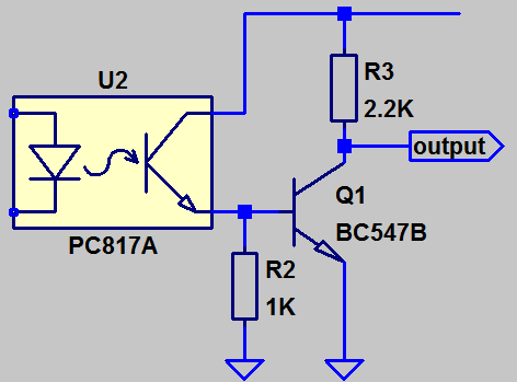

Hang on. This explanation doesn’t make much sense.
“R2 provides positive feedback to the base of the phototransistor, helping it to snap on faster by adding to the photo-electric base current when the transistor starts to turn on.”
First, R2 doesn’t connect to the optocoupler base except through 2 Mohm R1. The time constant there is going to be a few microseconds, generously assuming the base to be less than a few pF.
Second, the base of Q1 (and therefore R2) can’t swing more than 0.7V above ground.
Third, R2 is always more negative than the base of the phototransistor: there’s no way it can add current to the base of the phototransistor.
Pease, Himself, doesn’t describe the circuit that way: he claims it gets it to only 5 us, not 200 ns, and He abbreviates the explanation, saying R1 is to “tailor the bias”.
My guess is that R1 just biases that phototransistor further off, and removes photo-generated charge faster when the light stops, rather than waiting for charge to dribble away through the base.
My guess is that R1 and R2 labels need to be switched.
I tried the schematic myself and I also did a LTspice simulation and it seems like either I miss something, or it doesn’t work:
https://cdn.hackaday.io/images/4024401526020026370.d75a6638d144cc3f7e9b167b32c2350a
It seems to me like he is trying to bias an NPN transistor (the one inside the opto) with the emitter.
I automatically thought of my project and tried to see if I can improve the slopes of my mosfet and then tried with a bipolar transistor and then with multiple optocouplers and transistors, different values, voltages and resistors. The effect it’s the same and I don’t know where Elliot Williams took the schematic from. Any additional info, Elliot?
I’ll keep trying maybe to switch the resistors between themselves. Here is my project page:
https://hackaday.io/project/94905-hakko-revenge
Oh, yes. I ran the simulation again. It seems to be working only if you put that 1K resistor into the collector of Q1. I can see why. That does not help me very much and I cannot implement this in my schematic.

If you end up here trying to get a 4pin optocoupler like the l817, ltv817 or pc817 working for MIDI data transfer you need to use the following amplifier layout https://www.mikrocontroller.net/attachment/296701/PC8x7-MIDI.png as found on this german forum https://www.mikrocontroller.net/topic/400055
Without this the output will look like a bunch of shark fins with an 8k pull up and like a single blob with a 220ohm pull up (as per the fastest response time on the ltv-817 datasheet!)
Bob Peases original publication of this circuit has NO load resistor in the output transistor’s collector.
Obviously an error, but whose error ? I doubt it was Bob’s.
Hello. Thank you for the schematic, but there’s a smal error or misinterpretation possible in the schematic. Usually all ground symbols are tied to the same point. If you do that in this schematic, you loose the isolation and create a ground loop. Pin two of the optocoupler should be tied to pin 5 at the back of the midi in plug ONLY, and not to the rest of the schematic ground. The reverse protection diode at the input is also missing.
