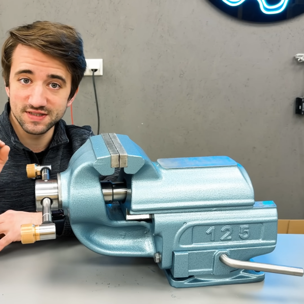

People say they don’t make em’ like they used to, and while this isn’t always the case, it’s certainly true that old vices rarely die with time. This doesn’t mean they can’t use a refresh. [Marius Hornberger] recently backed that up when he decided to restore an old vice that had seen better days.
When refreshing old tools, you’ll almost always start the same: cleaning up all the layers of grease and ruined paint. The stories that each layer could tell will never be known, but new ones will be made with the care put into it by [Marius]. Bearings for the tightening mechanism had become worn down past saving, requiring new replacements. However, simply swapping them with carbon copies would be no fun.
[Marius] decided to completely rethink the clamping mechanism, allowing for much smoother use. To do this was simple, just machine down new axial bearings, design and print a bearing cage, machine the main rod itself, and finally make a casing. It’s simple really, but he wasn’t done and decided to create a custom torque rod to hammer in his vicing abilities. Importantly, the final finish was done by spraying paint and applying new grease.

I didn’t watch the video but from the thumbnail as someone with experience with vices, you don’t want to have a ball or roller bearing on the handle because that limits the ability to hold a torque on what you are clamping.
when it comes to vices the simpler the better, the quick shift mechanisms do break from my own experience, and if you can get one with a buttress thread on the screw it will be even stronger. also try to get one without the soft roll keys that shear when you are unscrewing. i have to open my vice with a hammer blow to the jaw now because i don’t have time to replace that key.
While you could use proper roller bearings (for high load) and just add a clutch/brake mechanism for holding the clamping power it does get complicated rather quickly.
You could always add some bearings, possibly with spring loaded backlash takeup, to the retract mechanism with impunity. Many could use one.
I do like how this vicse (ficxed it) has a stationary outer jaw, so it will always be as supported, unlike a more standard design that becomes weaker as the jaws open wider.
