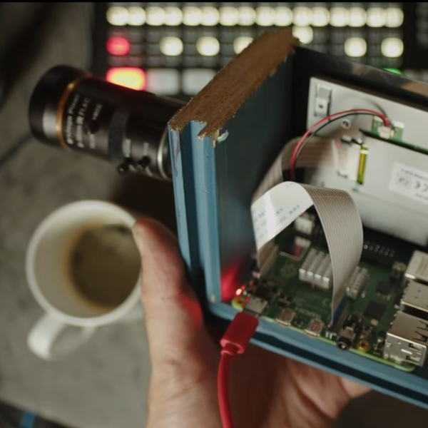

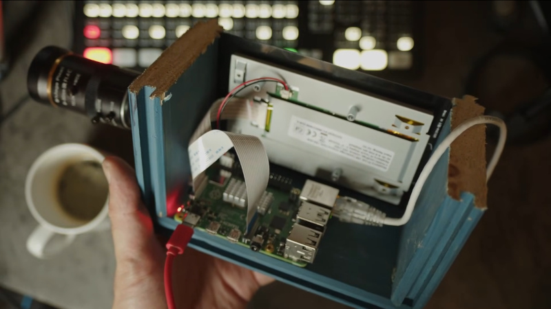

His camera hardware is very straightforward, a Pi 5 and touchscreen with the HD camera module in a rough but serviceable wooden box. The interesting part comes in the software, in which he’s written a low-latency GUI over an HDMI output camera application. It’s designed to plug into video mixing hardware, and one of the HDMI outputs carries the GUI while the other carries the unadulterated video. We can see this used to great effect with for example OBS Studio. It’s for now a work in progress as you can see in the video below the break, but we expect that it can only get better.
The video below exposes the obvious flaw in many Pi camera setups, that the available lenses don’t match the quality of the sensor, in that good glass ain’t cheap. But we think it’s one to watch, and could provide competition for CinePi.

  1. Hey author here, It’s actually based on the Pi 4, not the Pi 5 as with the Pi 5 the DSI output is no longer connected to the linux KMS system directly so some acceleration features don’t work on it. My plan is to migrate it over to the Compute Module 4 though.
    It’s also not competition for CinePi, that’s more focussed on very high quality video recording and this is purely for streaming video.
