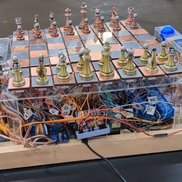

Over the last few centuries, behavioral psychologists have documented all kinds of ways of modifying our actions and the actions of various animals. From the famous Skinner boxes to many modern video game mechanics, animals and humans alike can learn through the addition or subtraction of various rewards and punishments. And it doesn’t only impact simple actions either; [Everything is Hacked] took this idea to the extreme, using painful electric shocks to teach himself to avoid making blunders while playing chess.
This positive punishment system uses a medical device called transcutaneous electrical nerve stimulation (TENS) to deliver an electric shock to the skin. The electrical jolt is routed through a custom-built, conductive chess board where each square is isolated from the others and controlled by its own relay. The pieces are conductive as well, so if one is placed on a square where it shouldn’t go a relay will switch on to quickly provide the behavioral modification. The control logic is provided by a Raspberry Pi running the Stockfish chess engine, and it keeps track of the locations of the positions of all the pieces by using MX switches in the base of each square on the board.
This project took [Everything is Hacked] over a year to get into a working condition, including having to rebuild the entire project twice after mishaps with baggage handling at an airline. But he was able to demo the board to the Open Sauce tech festival and even took it to his local park to play chess with the local hustlers. Unfortunately, he reports that he spent more time reworking and rewiring his board over that year than he did improving his chess game, so unfortunately he still hasn’t been able to win any of his money back yet. Perhaps combining this project with a chess-playing robot would help.
