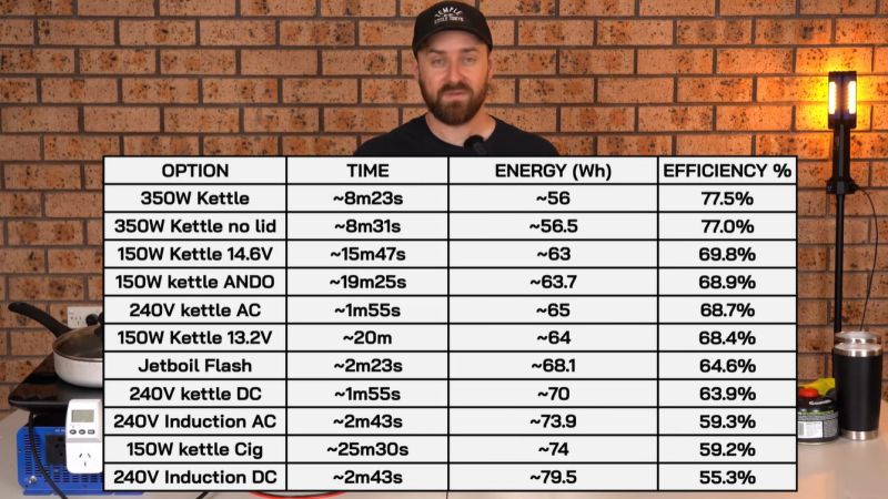

What’s interesting about this whole topic is that at its core the overall efficiency of boiling water is simply a matter of calculating the energy input minus energy losses, with the remaining energy going into the water.

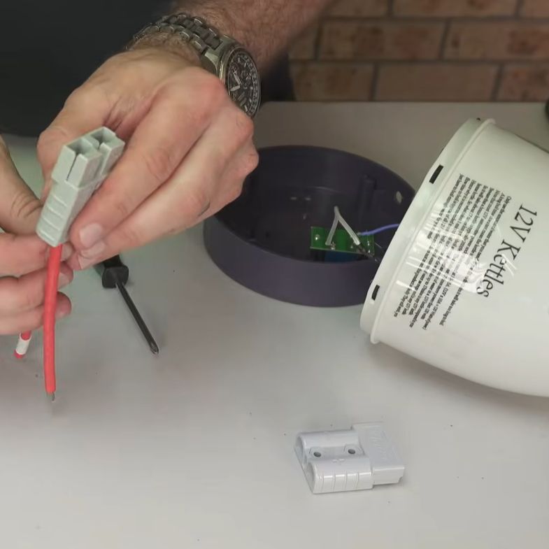

As we can see in the video, using a higher battery voltage  doesn’t really change the efficiency of a 12 VDC kettle, but the higher current draw does manage to melt a fuse that can’t take the heat — requiring a 20 amp fuse instead of the 15 A one.
One change that does make a difference is how it’s connected. Replacing the thin gauge wiring and the attached cigarette lighter plug on the 12 VDC kettle with beefier cable and an Anderson plug made things run cooler, resulting in an efficiency bump of about 10%. This cut the time required to get the water boiling by around 6 minutes.
Added to this test were an induction hob and an iso-butane-powered Jetboil, both of which scored rather unimpressively. For the induction option it’s obvious that a lot of energy is wasted by having the pan radiate it away from the water, while burning iso-butane loses energy through the exhaust gases. Ultimately what you pick to boil water with should thus be mostly determined by convenience rather than sheer physics.

  7. One glance at that chart tells me what I need to know. So long as I am in the US… skip the electric kettle and just use the stove. Reconsider this only if I ever find myself in a country with 240V mains. Unless I can find a kettle with a long cord that would plug into the electric stove outlet… Is that a thing? Would making it void my insurance? I might have to do some research now…
    1. The chart doesn’t cover any 120V kettles, but others have (like [Technology Connections] on youtube).
      Despite what you might expect, a 120V electric kettle will still typically boil water faster than a kettle on a gas stove or even a conventional 240v electric stove due to superior heat transfer.
      The chart does demonstrate that a 240v induction range would beat a 120v kettle handily, if you have one of those.
