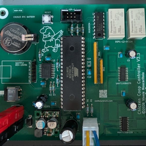

The system is built around a ATmega1284P, and calculates the sunrise and sunset times each day to know when to open or close the door. He’s built the system as a state machine which makes it more robust during power outages, which is a necessity since his chicken coop is mobile and is frequently out of range of WiFi and is battery powered.

Just because you used an ancient AVR in DIP case and crap screw terminals doesn’t mean it’s reliable.
The software design and simple hardware for the door are the reliability factors here, I suspect almost any circuit board in a proper weathertight enclosure would work just fine.
No, but the angry chicken logo does however.
I don’t think it’s angry, I think it’s dabbing. Which is… a choice.
i love the Atmega1284! I’ve specially got my I2C bootloader to work on it because it has so much RAM! A bit AVRs make for great I2C slaves for offloading things like serial line parsing from a beefier master.
