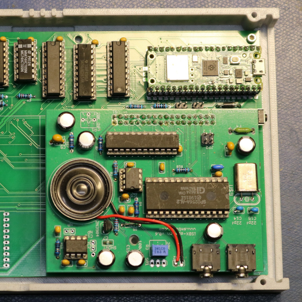

The GRiD arrived in one piece despite sketchy packaging, and after a little confusion over its line voltage it ran as well as the day it was made. It was designed to use GPIB as its interface for large peripherals such as printers or disk drives, so it was that interface picked for the speech synthesizer. It emulates a GPIB printer, and bytes are sent to the synthesizer chip by printing to LPT1, making driving it an easy process.
The synth itself is a clever design that allows the use of all the various speech chips of the day. It achieves this using a GPIB carrier board holding the interfacing, and a set of plug-in modules, one for each different chip. It’s certainly an unusual peripheral.
