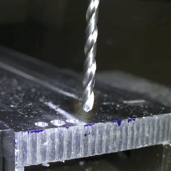

A drill bit, not apparently rotating, descends toward a block of aluminium and throws up aluminium shavings as it passes through the block.

  6. I haven’t watched the video but from the above clip of a drill bit it seems quite pointless to use a stroboscope when you can’t see the cutting edges of the tool. Watching the drill stand still and see bits of swarf fly off IMO doesn’t tell you anything useful. Surely the analysis of observing a rotating cutting blade actually slice the material is key?
