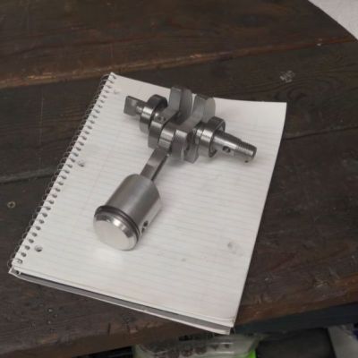

Recently [Camden Bowen] took a swing at machining a two-stroke engine out of billet aluminium, following adventures in 3D printing such an engine, as well as building one out of parts largely sourced from a hardware store. The sketchiest part here is probably the use of only a basic mill and lathe, making the milling of certain shapes a definite OSHA violation.
Two-stroke internal combustion engines are pretty simple from a mechanical point of view, with designs readily available. Add in a suitable material to machine and a modicum of machining and welding skills, and presto, you got yourself a not too shabby looking engine.
Of course, back in reality things are a bit more hairy. Not only are there many different ways to produce the parts – with some coming with a time penalty, monetary penalty, or both – but there are also myriad ways to hurt yourself and/or others. Fortunately [Camden] scraped by with just some (expensive) lessons learned and a major ruined part.
The final design features a single cylinder, with an initial pressure test showing a solid 150 PSI (10 bar) of compression. With that encouraging sign, a coil pack and contactor were added for some spark and a test run with the usual premixed gasoline-oil fuel.
Boringly, the engine mostly just runs and work as it should. This is of course not unexpected, much like how following the recipe for a pie produces said pie. But it does demonstrate how easy things are when you do not stray off the beaten path. The only significant issue was the flywheel wobbling slightly, likely due to a small manufacturing glitch, but this should not cause too many issues.

  3. Aluminum crankshaft?
    Bearings?
    Connecting rod?
    I know aluminum cuts like butter, but GD, that ain’t the easy or right way.
    Engine isn’t really hack, similar to many, but worse.
    Material choice is ugly awful hack, good lesson on what not to do, in line with previous clickbait.
    Production process appears to show that Camden Bowden’s purpose in life is to serve as a warning to others.

    2. Not sure where you got the idea that this engine was entirely aluminum,
      if youre too lazy to watch a video you probably should refrain from posting unqualified uninformed criticism.
      This maker used built his crankshaft by welding steel plates to a steel shaft
      But the 1935 Å koda 935 Dynamic featured a highly advanced, lightweight 2.0-liter 55 hp (40 kW) flat-four engine that incorporated an experimental aluminum crankshaft.
      This makers connecting rods started their lives as 1/2 STEEL rods.
      BUT the stock connecting rods for the 1940-1963 BSA A10 (650cc twin 35 hp) were made from aluminum alloy.
      This maker used standard steel bearings.
      But early Volkswagen Beetles featured solid, non-split aluminum bearings on the end mains (specifically often the center main), not the split steel-backed bearings common in later engines. While they were effective for longevity when properly lubricated, these solid aluminum bearings were prone to seizing if the engine ran dry.
      Modern engines frequently use aluminum-silicon or aluminum-tin bi-metal bearings for connecting rods and main bearings because they are cost-effective, durable (often lasting 200,000+ miles), and provide high seizure resistance. They are widely used in modern OEM passenger car engines, including Toyota, Lexus, and General Motors engines.

      2. Bearing shells with copper backing, in the hope of saving the c’shaft if the worst happens. BTW A10, and derivatives had Duralumin rods, which occasionally bent when 10.5 /1 pistons were fitted! Ciaran N. IRELAND

  4. Static ignition timing will waste a lot of the power potential of the engine. There ought to be a timing advance mechanism (or circuit) to improve ignition timing by adjusting it to engine RPM.
