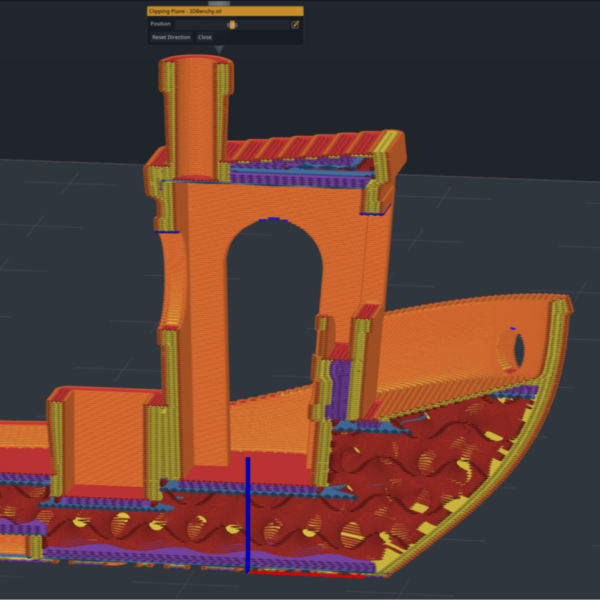

Cross-sectional view of Interlocking Perimeters, which increases Z-strength. Unlike brick layers, layer height stays constant.

  5. I’m very interested in the interlocking perimeters for some thin wall functional parts I build. But, my brain is not grasping how it works. Spacing and compression: spacing how? Compression where?
    Z-height is not manipulated, so horizontal spacing is manipulated to create gaps between lines maybe? Overextrusion on the layer above then pushes (oozes?) plastic into the gap below?
    For some reason, I’m not making any sense of the lattice looking picture.
    If nothing else, I do like the cross sectional view. It’s kinda cool. You right click the object when viewing it from the angle that you want to see it from. “Clipping Plane” then cuts a plane through the part normal(?) to the viewer’s perspective. Then you can push and pull that plane through the part, while also being able to traverse the slices vertically via the typical slicer slider.
    1. Likewise, I can’t make sense of their written description or images. I’d like to see a simplified graphic rather than the slicer preview screenshot.
      I THINK what they are trying to draw our attention to in the cross-section image is the leftmost column of blue lines. It’s an additional inner shell that this feature adds. It alternates thick/thin as you move vertically. This might provide some inter-layer adhesion since the thick lines overlap into the layers above and below?
    2. If I understand correctly its pretty simple. Print a layer and leave half of the perimeter lines unprinted in an alternating pattern. When the next layer prints on top of a missing line it prints with 200% extrusion rate. This fills in the gap and creates a line 2 layers thick. Seems like an excellent idea to me.
    1. From the link: “5-15% estimated Z-strength increase with no time or material penalty.” and further down: “The beads generated over the previous layer’s interlocking beads are printed in an alternating pattern at up to 200% flow”
      1. Good catch – we’ve clarified this on the site: “The interlocking shells occupy the same space that additional perimeters would. Compared to filling the same area with regular walls, there is no time or material penalty.”
    2. From the website: “each layer’s beads fill the previous layer’s gaps”
      Thanks! That seemed like the most reasonable approach that I could extract from the previous description. I was finally able to spot what was happening by looking at a sliced object layer by layer with the feature turned on.
