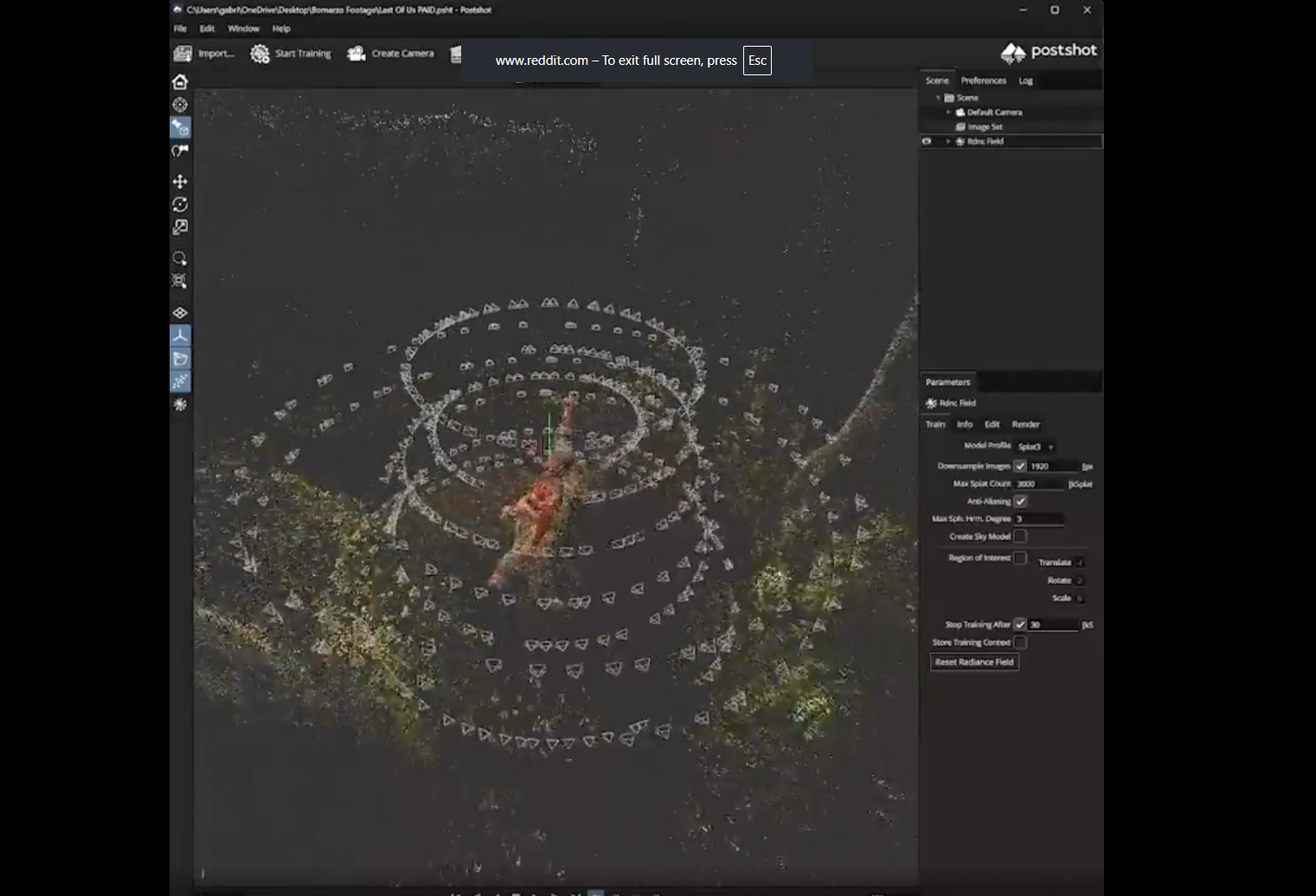

Here’s a pretty clever method [Dung3onlord] used to capture 3D scenes from a PlayStation 5 without needing any specialized software. All that’s needed is a series of high-resolution screenshots, and a few software tools.
The process is essentially photogrammetry, it just uses screenshots as the input instead of photographs.
Instead of sneakily yanking 3D assets from the runtime, he fires up the game’s photo mode on his PS5. By capturing an orbiting video of a static scene (making sure to hide the game’s user interface, something photo mode in games is good for) he ends up with a video file whose content — essentially a series of screenshots — can be used to reconstruct the original 3D scene. The workflow [Dung3onlord] uses has rather more steps, but conceptually that’s all there is to it.
The whole process is remarkably similar to photogrammetry, a method of turning a bunch of photographs from different angles into a 3D point cloud. We’ve seen photogrammetry used to digitize objects because point clouds can be turned into 3D models, essentially allowing one to 3D scan an object using little more than a digital camera.
In [Dung3onlord]’s case, once the point cloud is cleaned up and background removed, the scene is used to generate a gaussian splat which is then viewed through a VR headset.
Gaussian splats are especially well-suited to displaying colorful, organic 3D scenes that look pretty fantastic from any angle and are computationally simple to view. Want to see for yourself? [Dung3onlord]’s resulting scene is available to be viewed online.

  1. Games can fake 3D with things like bump mapping. That’s gonna mess up the process.
    I remember popping on one of the early 3D goggles in a computer store, playing some game on a demo machine, and what looked proper on the monitor became like cardboard box village in 3D. Turns out, when you look at a bump-mapped polygon with two eyes, it becomes very apparent that the depth is just painted on.
      1. It depends on whether the scene scanner can correctly capture the intended geometry rather than the actual low-poly model, or some Frankenstein mish-mash between the two.
    1. How is that going to impact photogrammetry? So long as the painting on behaves as expected the model should come out right.
      1. So long as the painting on behaves as expected the model should come out right.
        It doesn’t. Suppose you model a rock as a sphere and apply a bump or a normal map – the outline of the rock and the shadow it casts would still be a perfect sphere. The silhouette of the object and how shadows land on and off the object follow the true geometry of the model instead of the texture map. This is easily ignored in a 2D view.
        Displacement maps allow you to add real geometry to simpler primitives, but it takes more out of the GPU, so bump/normal maps are used to speed things up instead, especially on minor details and decorations that don’t stand out too much.
        1. Also the fact there could be shaders or other visual processes involved that your plain old rasters ignore.
