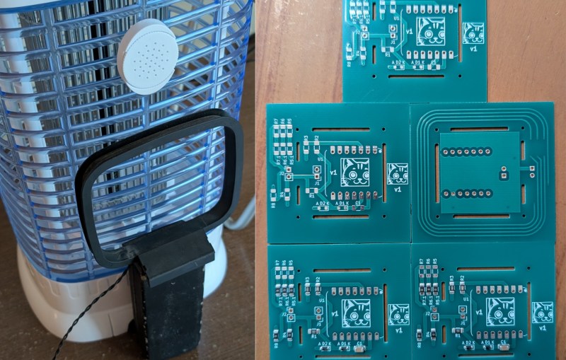

But how exactly do you detect a bug zap? With an antenna, of course! When a bug gets caught, it arcs, creating an electromagnetic pulse. A small loop antenna on the backside of the zapper receives the signal.

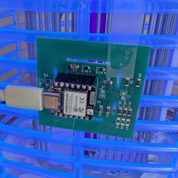

The final PCB, attached to the bug zapper.
It was also in part an experiment to see how good you can “vibe-EE” and, well, mixed results. Claude was able to correctly identify basic concepts of EE needed here, but was largely worthless at making schematics. After some manual circuit doodling, then building, [Nicolas] successfully got an ESP32-C6 to detect the voltage spikes.
Of course, where there’s data, there must be a dashboard. Using existing graphing libraries and a custom PCB, [Nicolas] has the ultimate bug zapping experience.
