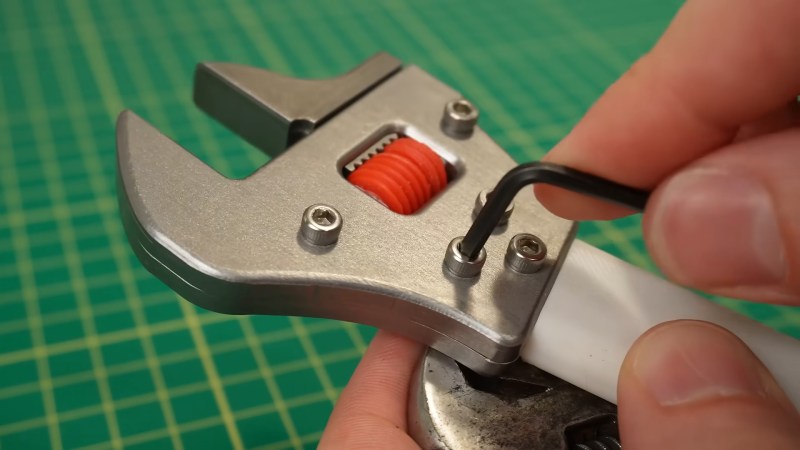

We’ve probably all got one item in our toolboxes or chests that we really, really don’t like, but find too handy to toss. For [Someone Should Make That], that item was the bolt-rounding adjustable wrench. Rather than continuing to gripe about it, or alter his habits to make greater use of the full wrench set he also owns, he decided to build a better mousetrap. By mousetrap, we mean adjustable wrench.

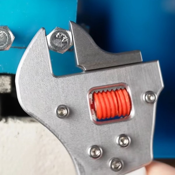

It took a couple of iterations on-screen before he hits on a solution that seems to work quite well indeed. The problem [Someone] had with his adjustable wrench was one of physical slop: once adjusted, there’s just too much play in the mechanism, which results in rounded-off bolt heads. [Someone]’s CNC’d solution takes inspiration from the CNC machine that manufactures it: he’s using spring-loading in the adjustment screw akin to what you find in the anti-backlash nut on your CNC mill or 3D printer’s ball threads. The tension from the springs keeps the wrench tight to the bolt, and that keeps [Someone] from rounding them off. Speaking of 3D printers, he prototyped in plastic before machining, and the screw in the end product stayed that way. It would be interesting to see how well that holds up.
Not only do we appreciate that it’s solved a common problem many of us have, the ethos of “this angers me, so I shall hack it” is one we support 100%, so do give a watch unless you’re one of those people who absolutely can’t stand videos, even when they’re spring-loaded to have no slop. There’s some good tips for beginner CNC operators in there, too.

  4. If the spring pushes the wrench open instead of closed then this would reduce the slop. The article makes it sounds like the spring is pushing the wrench closed, but I didn’t watch the video to check.
    Btw you can reduce this problem by being careful to put the wrench on the bolt so that the force between the adjusting part of the wrench and the bolt is closer to the main body of the wrench. Much less slop that way.
    1. I mean for any adjustable wrench it makes a difference if you flip it over so the force on the moving part is closer to the main part of the wrench.

  6. Some thoughts from a lifelong aircraft mechanic (where adjustable wrenches are verboten). Buying decent adjustable wrenches will mitigate slip off a lot. Regardless, adjustable wrenches, even of the highest quality, will have a bit of free play. Simply actively thumbing the worm screw to hold the freeplay out will stop this problem, as it takes tremendous force to backdrive that adjuster worm screw. All this said, a superb hack indeed, well done.
    1. Same here – I just use my thumb as the pre-tensioner and make sure that as you put the wrench on the nut you actually tighten it up snug to the fastener, not leave it slack.
