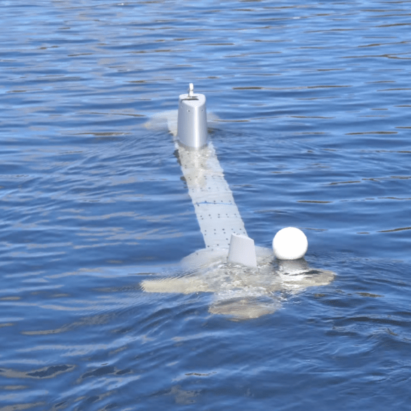

Of all the remote-control vehicles one can build, a submarine is possibly the hardest: if something goes wrong with almost any other vehicle, it’s easy to recover and repair, but a submarine is a very different affair. This nearly lost [James] of [ProjectAir] his latest project, a 2.7-meter long RC submarine, but it survived to make a few test sails.
Before building the full version, [James] made a test prototype. These submarines use large syringes as ballast tanks, pulling water in and out of the submarine body. The plungers are driven by a lead screw, and have a linear potentiometer for feedback. This can be wired in the same way as a servo motor, making it compatible with the RC controller. The controller receives its signal from an antenna in a buoy tethered to the submarine. Since initial tests worked well, [James] moved on to the full-scale model.
This was made out of radially-arranged acrylic tubes, with all but the top tube left open to the water. At the back of the submarine there were servo-actuated fins and a propeller, which would allow it to steer, ascend, and descend underwater. To waterproof the servo motors, [James] sealed them as much as possible, then filled them with oil. The other water-exposed electronics were either potted in epoxy or coated with a waterproofing compound. During testing, the submarine descended without issue, but was reluctant to resurface. Most of the external components had been 3D printed, and water infiltrated the infill below a certain depth. [James], however, managed to recover it before it was permanently lost, and managed to make a few other dives at a very limited depth.

  4. I wouldn’t trust layer lines to be water proof, at least not with out a layer of sealant. There’s several waterproof varnishes on the market that can fill the spaces and even make it food safe within reason.
  5. this video could be titled: things you shouldn’t use 3d printing for. it’s a lot more than just the water proofing, every aspect of the 3d printed components is carefully chosen to be best performed by another process.

    Most systems use either a “wet hull” or a dry hull. For 3d printed, a “wet hull” design where the outside doesn’t have to be waterproof would be best. All the electronics, guts, etc live in a smaller sealed pressure hull and there are commercial versions of this. admittedly not as fun as roll your own though. Waterproofing one thing much easier (not easy.. easier) than waterproofing many things, and fixing something is easier instead of cased in epoxy, oil, whatever.
