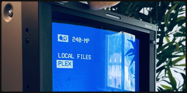

If you have a TV and a Pi, you have the workings of a media center, and you’re not exactly short on options for software. But options are good, so here’s one more by [Anthony Caccese] — a player called 240-MP that explicitly targets CRTs with its retro stylings, released under the GPLv3 license.
Don’t let the name fool you, though. While the blue-and-white styling is very evocative of 90s VCRs, the output isn’t limited to 240p. If you’re running it into a vintage CRT over composite, as [Anthony] does, sure, it’ll do that. If you want to use HDMI on a modern TV, however, that’s an option too, in 4K if that’s your jam. Higher resolution video will need a beefier Pi, of course, but MPV can handle the files, and ultimately this is a wrapper for MPV. You still get the vintage styling, which can do green-and-black as easily as white-and-blue, as well as whatever custom color scheme you want to define. It might not look quite as good if it’s not on a display tube, but we could see this as a good fit for a plasma TV, too.
As you can see in the demo video embedded below, the player is equally happy listing and playing local files — including playlists — or streaming via a PLEX server. Other add-ons, for example to launch emulators, may be forthcoming. Of course, if you’re not willing to wait you could always code them yourself.
