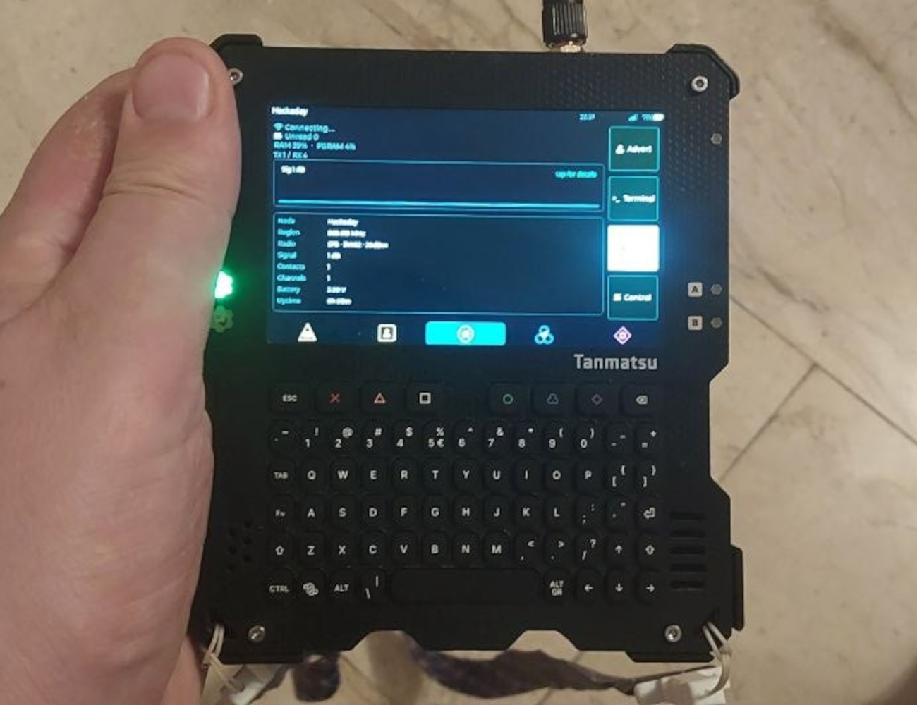

Turning the Tanmatsu on, after a synthwave-inspired splash screen you find yourself in a graphical menu. The user interface is pretty intuitive to anyone used to a desktop GUI or a modern smartphone, along the top are status icons for SD card, Wi-Fi, and battery, the main body of the screen has a grid of icons, and along the bottom is a list of the various keyboard shortcuts. Navigation is via a set of arrow keys with the return key selecting an option, and a set of coloured function keys handle special functions.
The Tanmatsu handheld computer showing a screen from the Wadamesh Meshcore app.
Meshcore is only a download from the repository away.

In use the Tanmatsu is convenient to hold and type with using two hands. The display is clear and bright, and the keyboard while a little on the small side has a positive click action. Using the apps depends on the individual choices of the app developer, but the interface conventions are straightforward. I’ve been using it for Meshcore for a while now, and it makes a very handy terminal indeed.
