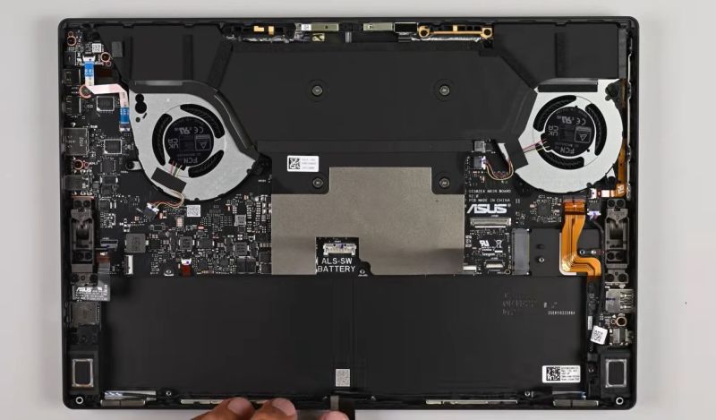

Recently Asus determined that their Asus ROG Flow Z13 – model GZ302EA – scored a 10 out of 10 using this system. This led [iFixit] to run the same tablet/laptop hybrid through their own rating system.
You can find the filled-out spreadsheet for this device here, with this Asus-provided site showing a list of devices that all score a 10/10 or a measly 9.9/10 according to this system. As a self-reported score it is hard to take it as the objective truth, as there is every incentive for the manufacturer to tweak the truth to their own benefit and gloss over inconveniences. This is where it’s interesting to compare it with [iFixit]’s 7/10 score.
On documentation, Asus gives itself a perfect score but [iFixit] finds it to be incomplete. Removal of one fan requires the disassembly of the cooler with its liquid metal thermal interface on the CPU. The wireless card, and most ports, are soldered to the mainboard. On the bright side, after you get the screen off, the insides are quite modular, which is a plus.
[iFixit] dings three points: for documentation, soldered-down components, and a fan accessibility glitch. Parts accessibility outside of France is also significantly harder, but one can hardly blame the French system for that. Overall the French self-reported rating would seem to be a fair start, but depending on which criteria you define as required you may find yourself disagreeing with the score.
In the case of LPDDR5 RAM one could argue for example that with LPCAMM2 modules soldering RAM onto the mainboard ought to be a thing of the past, and Wi-Fi modules should always be removable as well. You can take that up with the French regulators.
