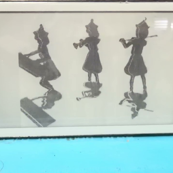

20 FPS On E-Paper Display Without Help
If electronic paper displays have one downside, it’s generally refresh rate. Earlier versions of the tech might only have been able to do single-digit frames per second, while modern, mid-range devices can sometimes manage 10-20 FPS — and that’s not including the frames needed to blank the display. Getting up past that double-digit barrier typically requires higher-end displays, more powerful processors or FPGAs, and more money. On the other hand, [Tony] was recently able to get 20 FPS out of an ESP32-based device without using any extra processing power.
The key to improving e-paper performance is understanding how the display actually works. The “ink” consists of microscopic charged pigment particles that physically move in response to electric fields, making the display much slower than LCD or OLED panels. Rather than fully erasing and redrawing every frame, the software takes advantage of the particles’ existing state by generating optimized driving waveforms that only move the particles needed to produce the next image. On the software side, an MPEG-like encoding is used so only changes between frames are transmitted and converted into these waveforms, reducing unnecessary data transfers and allowing much higher frame rates.
[Tony]’s method is able to drive 960×540 panels, like those found in the Lilygo or M5PaperS3, to 20 FPS, and these platforms are based on nothing more than the capable but limited ESP32 chip. It’s an impressive push, and worth checking out the video in the linked project page. We assume you’d need a little more to drive something like the massive e-paper display found in this home automation setup, though.

        1. This is the fast waveform. Its very kind in that it doesn’t move the eink that far…it can’t – eink takes time to move. So the movie shows blacks as greys. BadApple is also kind in that pixels don’t move that much compared to frames.
          The calibration is all my own, well, lots of trial and error to get the right waveform to show right.

    1. Due to the squishy nature of pulling magnetic dots through fluid, it actually is a little more complicated than just figuring out which pixels are different between two frames. Even for regular B/W changes, but expecially for grayscale, the “waveform” you apply to a pixel (sequence of on/off for a given number of periods at a specified clock) matters a ton to get a good output. These tend to be proprietary to the screen manufacturer, dependent on temperature, and distributed under NDAs and as binary blobs. Their LUT nature is why so many drivers are FPGA based.
      I don’t think that this firmware implements them (at least not properly), as there is a lot of ghosting and grayscale remnants (I’m sure there’s a more proper word for this) following motion. The demo video itself demonstrates why waveforms are important. Still a cool project.
