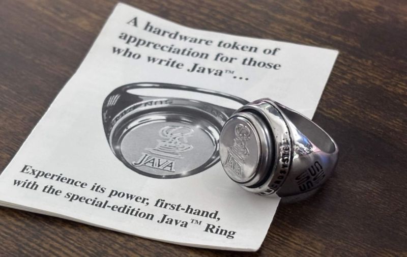

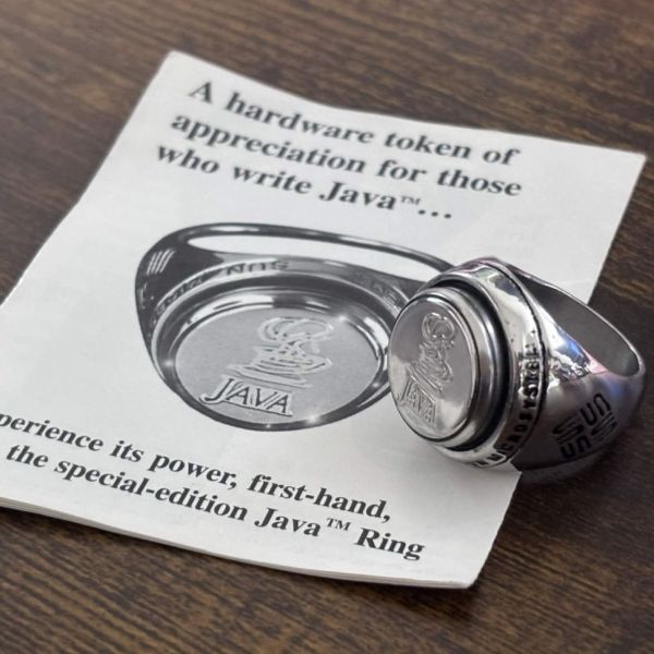

Back in the late 90s when absolutely everybody knew that Java was going to become the one programming language to rule them all, the Java Ring was handed out to folks at Java developer conferences as an example of how it was going to revolutionize smart wearable devices. Recently [Daisuke Yamazaki] got his mittens on one of these collector’s items to see about reviving it.

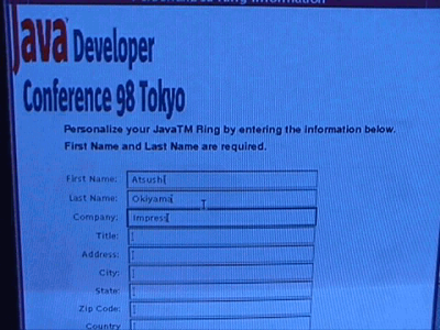

We talked about these rings and associated iButton devices before, with their intended use being primarily to act as authentication keys. For the Java Ring, this use was mostly just used as a kind of gag, whereby visitors to these conferences could specify their coffee preferences at a terminal, having this programmed into the ring so that they could get their desired cup of literal java at various bean juice dispensers around the conference site.
Talking to one of these iButton devices requires a so-called Blue Dot adapter, which [Yamazaki-san] purchased along with the ring. Although the device happily responded on the 1-wire bus, figuring out how to interact with the original Java-based firmware and answering the question of how much of the original information of someone’s coffee preferences in ’98 were retained would require more sleuthing.
After recovering an installer for the Dallas Semiconductor’s IB-DE IDE from the Wayback Machine, this posed the next problem. As it was a 32-bit Java binary, which didn’t play nice with the modern Java 25 runtime and belying the ‘write once, run anywhere’ marketing phrase of back then. Downgrading to 32-bit Java 1.8 with since removed communication APIs helped here.
With the IDE in place, the traffic between the Java Ring and the PC-based software could be analyzed to figure out what was going on. This revealed CRC errors that pointed to the built-in lithium backup battery having expired. Unfortunately the stainless steel case is meant to be sealed and thus turn into e-waste the moment said battery calls it quits. Here fortunately a Japanese TV program picked up on these efforts and featured his efforts on national TV.
This led to the happy ending, with some help with others in replacing this battery. This also answered the question of which parts of the firmware and data were in the battery-backed RAM and which in ROM. Although full details of the findings here are a bit scarce, it seems that the original data was lost along with the dead back-up battery, but the ROM retained the JVM and allowed for a new program to be eventually written to the device and retained across reader sessions.
